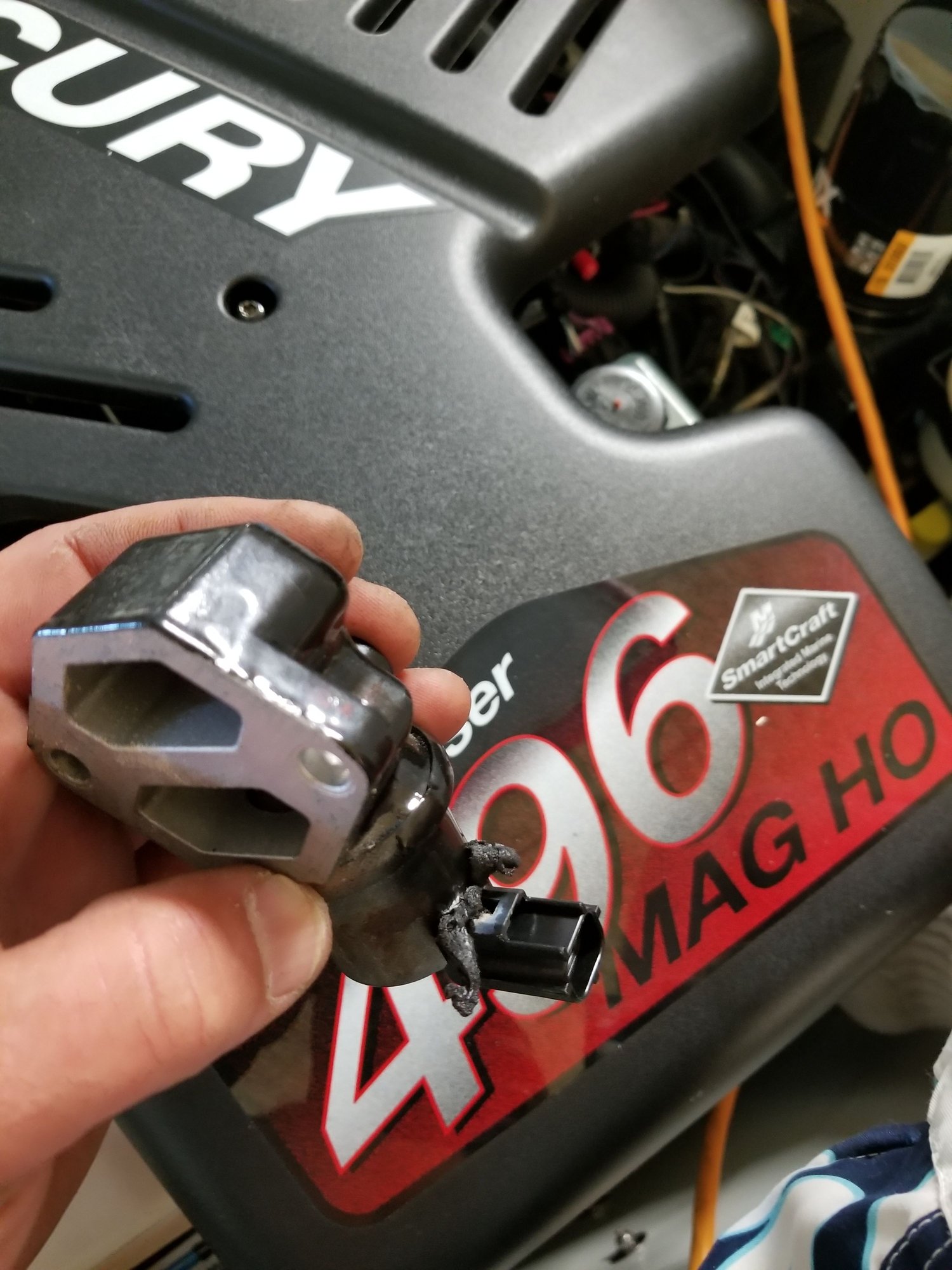

If I recall this went on for a while as to what your problem was - Or am I off base on the timeframe. Anyways a scan tool tool would have picked this up on the spot with the scan parameters showing an IAC out of spec even without a warning fault and or a displayed fault code. Wanted to make it known that just because a fault is not shown does not mean too much. Its all about the parameters to find issues to help pin point
Correct a couple years ago. He kept bringing it back and forth to the local shop. You would have to take it up to the local shop and there parameters and troubleshooting. After 5 trips and countless $$$$(computer, fuel pump, cam sensor, filters) in parts they threw at it, they still didn't have it fixed , . I plugged into and well didn't even need to get passed the hours screen. I could clearly see the IAC melted . I dont remember if it had 152 code or not.
I can report the issue has not come back. He ran all last season with zero issues.
Plaineman he got lucky sort of. Harness was good just the IAC. Weird it was the exact same thing you boat was doing. Careful it did fry one of his computers.

couple of things 9 out 10 times when IAC connector is melted and or started smoking or even a small flame - the pcm IAC circuit internally gets taken out as well for a jist. And about 75 percent of the time as why the connector starts smoking or melts is usually poor / missed maintain in the IAC areas / related systems and or an engine over heat(s) damaging the harnesses and connections.
