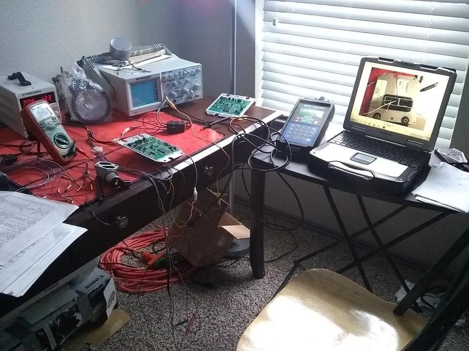

Cool, got any photos what the inside of the PCM looks like?
I have in the past up here. Also on my FB page I try to post a good tech tip once per week. Most of that is about ecm s and fuel injectors and a few odds / ends testing that I do. A little bit of it here.https://cimg2.ibsrv.net/gimg/www.off...14fbf61110.jpg
