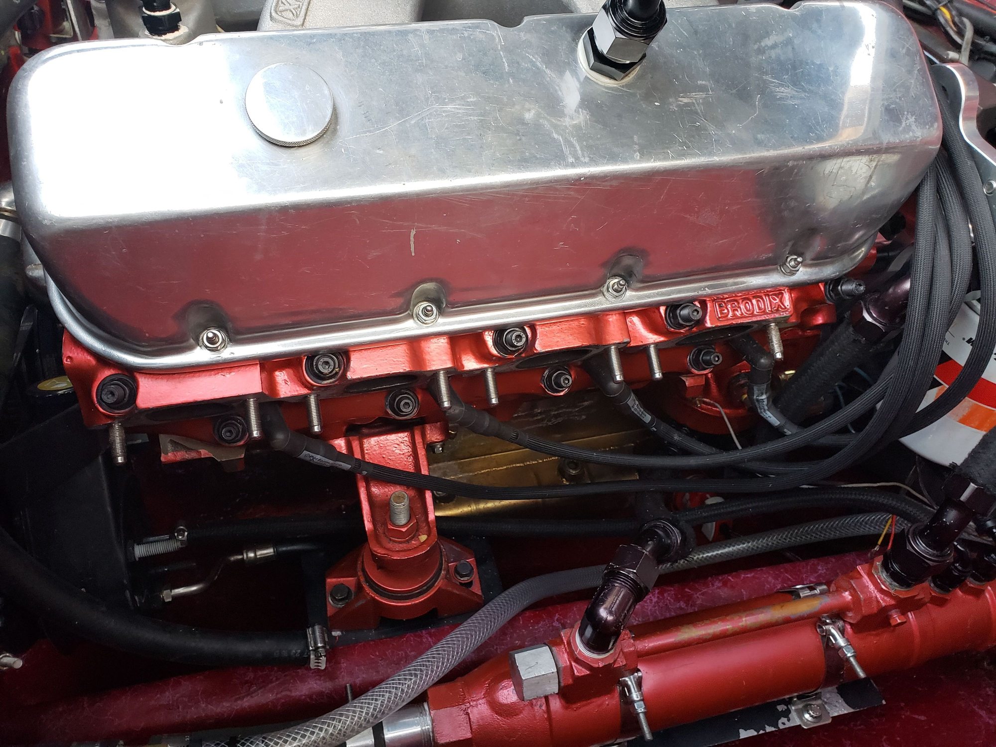

I installed the ARP stainless studs on my Brodix heads to install lightning headers. I ended up having to remove one on each side (forgot which ones) and install short bolt due to clearance issues. I did snug them down with the old 2 bolt method and have no thread issues. I checked them every time before we went for a while and they stayed tight.
https://cimg3.ibsrv.net/gimg/www.off...79a8386e40.jpg
