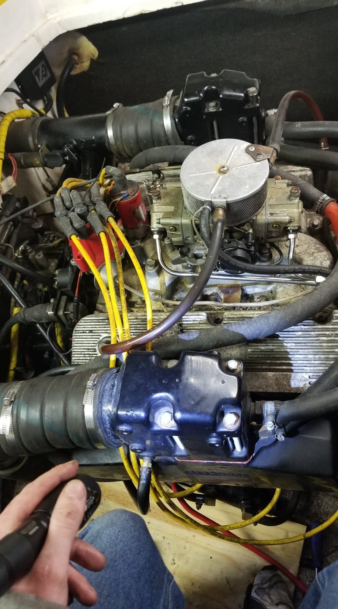

bhassett110 02-23-2019 10:14 AM
https://cimg4.ibsrv.net/gimg/www.off...44e12b00a7.jpg
https://cimg7.ibsrv.net/gimg/www.off...440e628049.jpg
These are pic of how the old exhaust was setup to help with some new better options for what I'm trying to achieve. Stock style aluminum Glenwood replacement manifolds. The boat is currently being partially redone front and mid stringers, tank, helm, ect.
