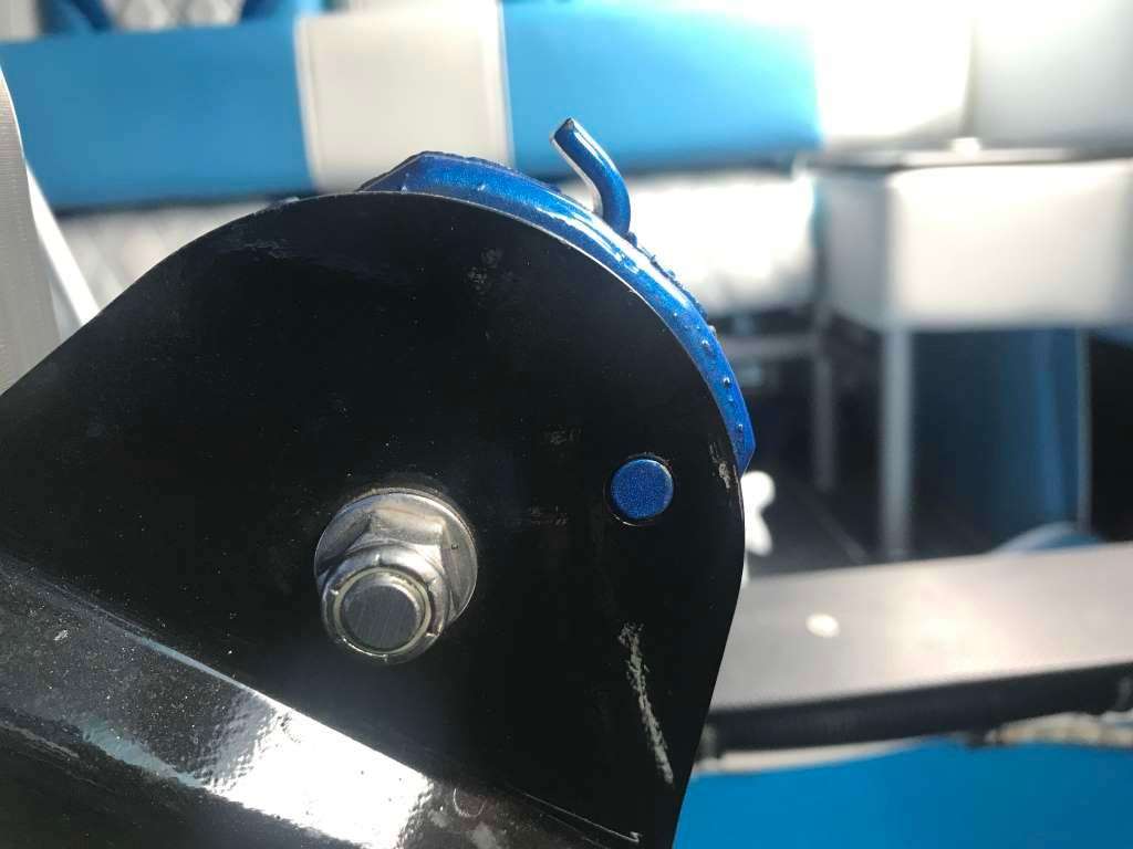

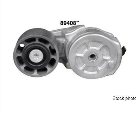

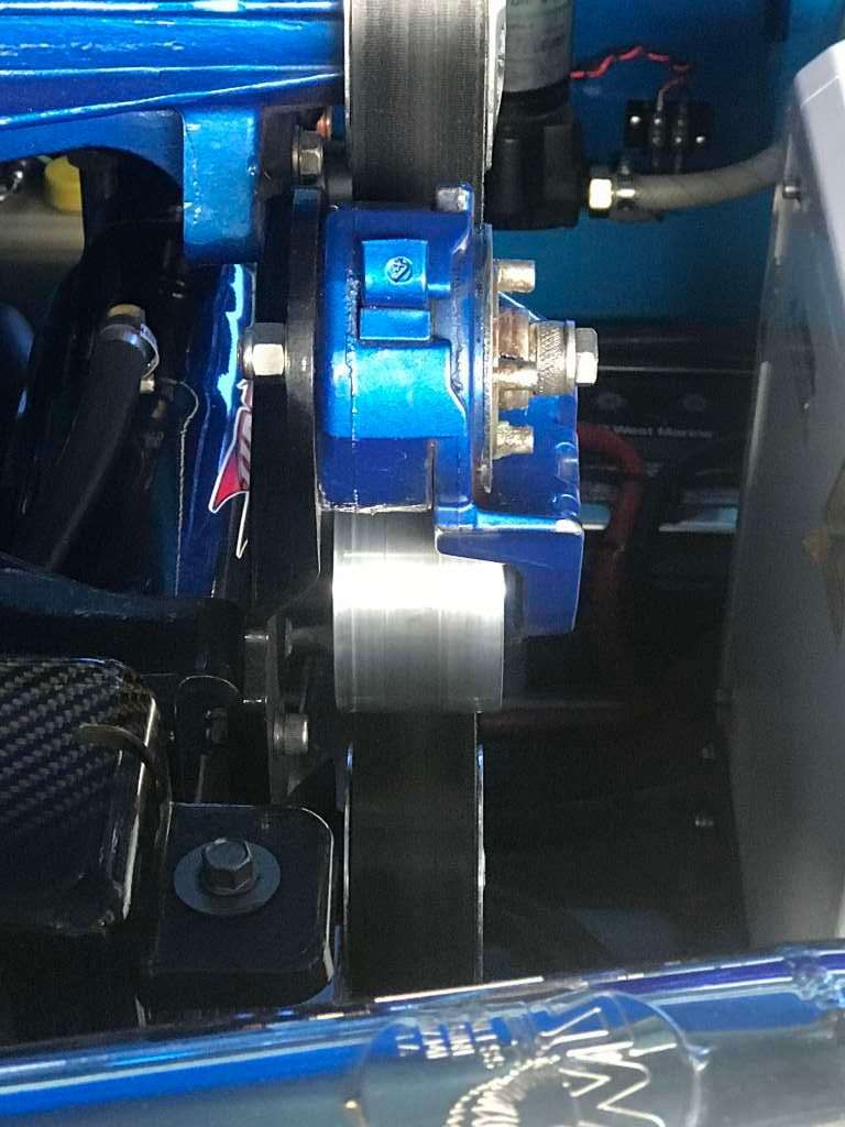

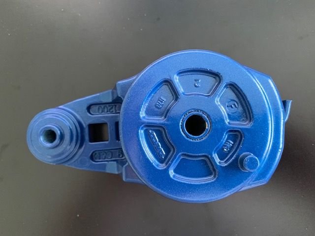

Okay here are a few pictures of the tensioner and the pin guide location on the back. What I know is that it isn't a screw, rather a molded in pin like the "89421" above. After looking through a ton of pictures of the tensioners, I believe it is "89408" because of the location of the pin on the back. I've also attached a pic of the back of the bracket it bolts to which shows the location of the guide pin.
You can see that the tensioner spring is not straight up and down, rather twisted a little to the left. On the back, you can see the guidepin location in relation to the bent over spring.
The closest match I could find is the "89408" in terms of the look/shape of the tensioner and guide pin location.

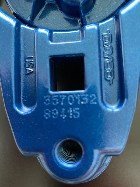

Actual part number from Dayco is 89415. Pin is in the proper location.
~ $105.00. Ouch! I bought a bunch a few years ago. Picked them up for about half that to replace originals and have spares.
Cleaned, sprayed with zinc chromate primer, painted with Merc color from the can.
UPDATE: Check find it parts. Selling for $89.19 each.

89408- Pin is not in the proper location. Close though.
So, a Dayco 89415 ?
Here's one $45 from ebay.
https://www.ebay.com/itm/New-89415-D...-/162275283610
