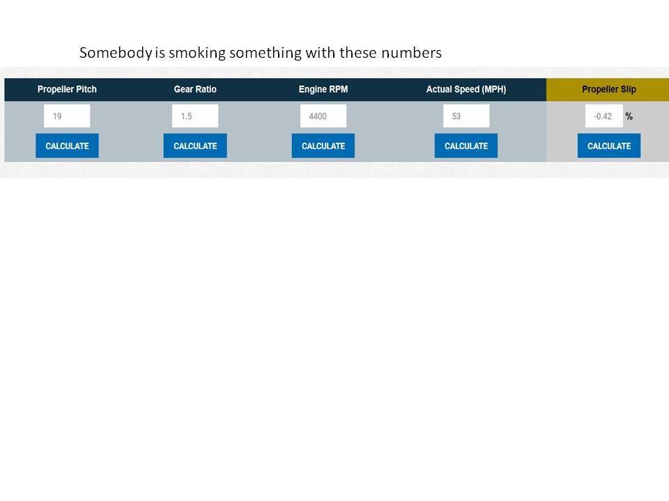

my ratio is 1.50... i've tried to use the mercury calculator but theres no prop diameter input...
This doesn't add up

guimond47 05-30-2019 07:29 PM
Originally Posted by AllDodge (Post 4689175)
This doesn't add up
sorry,typo. The 19p mirage i was at 5200-5300RPM.- 54-55mph
23P prop was 4400-4600 depending on trim- 52mph

AllDodge 05-30-2019 07:36 PM
Better numbers
https://cimg4.ibsrv.net/gimg/www.off...9d36edfb63.jpg
guimond47 05-30-2019 07:38 PM
Originally Posted by AllDodge (Post 4689182)
Better numbers
so the 23p has about 10% more slip. but now if the 23P that is currently 14-1/4" was bigger in diameter like 15.6". slip should go down....

AllDodge 05-30-2019 07:48 PM
Maybe, lots a variables in there and slip reduction is good, but sometimes a bit more slip means higher mph. All depends on how well power is transferred from the motor to the prop to hull
