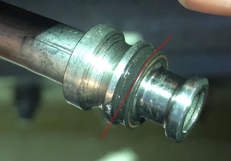

Could use some help. Have a 496 HO. Just had the injectors cleaned and installed a brand new cool fuel system with the help of BUP.
I have developed a leak on the end of the fuel line that plugs into the cool fuel unit. There is a small ORING on the fuel line.

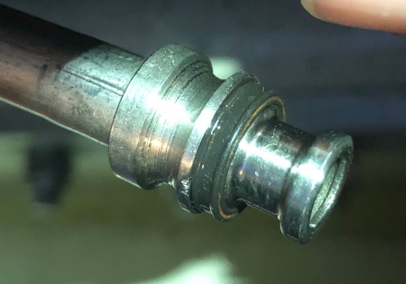

Does the Oring go here. This is where it was when I took the unit apart.

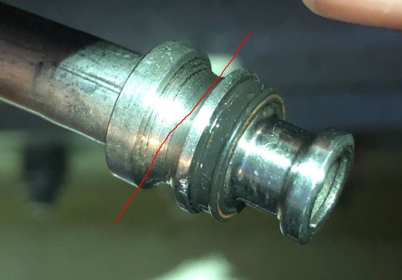

or does it go here?

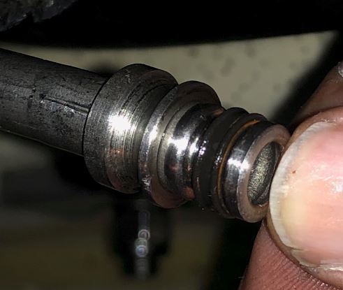

Next question is I am having a hard time getting the fuel line in either oring configuration shown above seated fully into the cool fuel module.
Picture below shows where the cross pin/screw that holds the line in place should go.
I didn't realize this when I first installed the line but the cross pin went through more in this area.
I been trying to get this connected for a few hours now and cant seem to get the fuel line fully seated that last 1/16 of an inch or so I have also damaged the o ring in the process and have to order another one. I have spent way to much time with this. What is the trick? Do I need a special tool?

Mine used 2 O rings back to back in the first slot
Looking a Gen 2 cool fuel I'm seeing in the manual. also 2 O rings, but at BAM I'm seeing part number 25-805063 (quad ring) O ring .301x.070 (item 27)

He has the GEN 3 cool fuel assembly - it takes a quad ring seal and Merc is the only place to get the correct one. Also I already sold him all that stuff brand new and gave out how to install all correctly. Its his first time ever doing the job so I can see where a mistake can happened.

Been looking at the ring in your pic some more, and the distance in the pic (orange lines) does not look like its .301 width. This distance is a bit less the 5/16 and 5/16 would cover the area (IMO) the bottom opening

Everything went back together as expected with no leaks.
Only explanation I can think of is my oring expanded and I couldn't get it seated properly. Must of been the silicone o ring lubricant I used instead of 2 stroke oil like you recommended.
