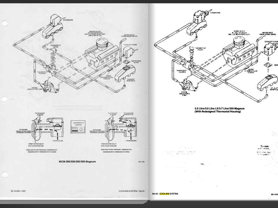

Being a 88 with a bravo drive, and mans are hotter then elbows (risers) I'm guessing your cooling system looks like this on the left, same as small block
I would look at the man to riser gaskets first to see if there clogged up

Yes that’s the one. I can blow the hoses pretty easy right at the thermostat and hear the water bubbling inside the manifold so it is getting a little

Looking at the fluid schematic prev posted, the manifold hoses don't really flow until the thermostat opens, then you get hot (~150 deg) water to the manifolds. Did you check flow to manifolds with eng warmed-up (thermostat open)?
You can buy some reinforced clear hose and temporarily install it just to watch water flow. Safer then pulling off a hose with hot water flowing.
