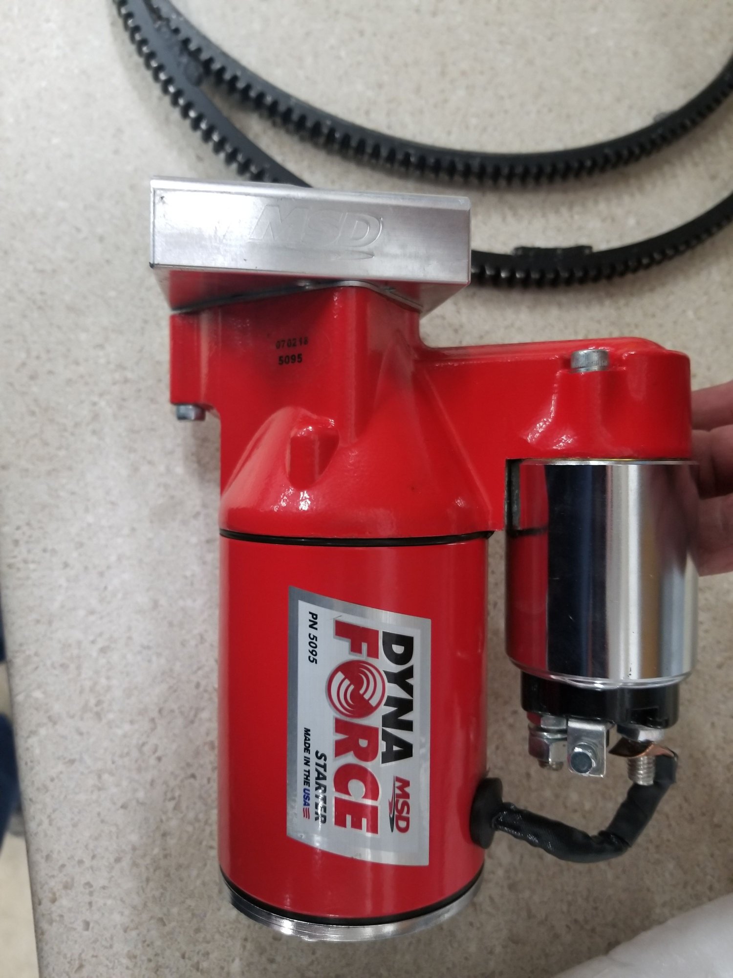

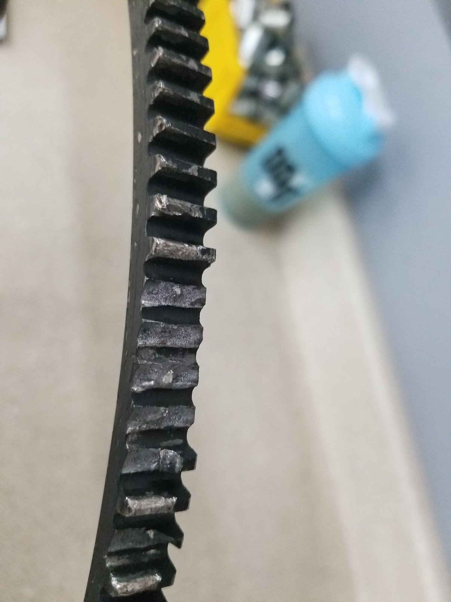

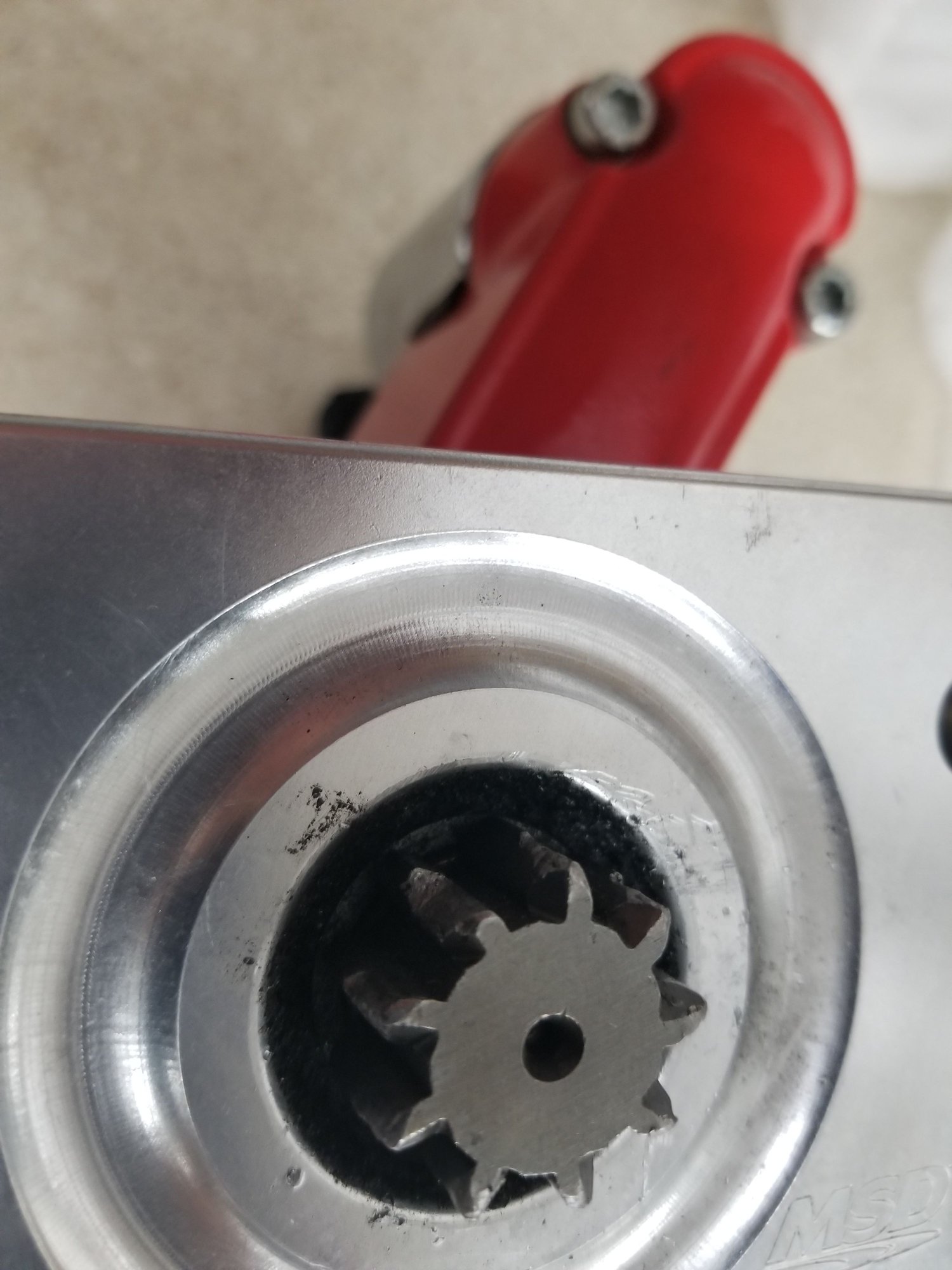

SABER28 06-27-2019 09:30 PM
https://cimg1.ibsrv.net/gimg/www.off...c7459941da.jpg
https://cimg2.ibsrv.net/gimg/www.off...5fb4186e9f.jpg
https://cimg0.ibsrv.net/gimg/www.off...8cdced5d8d.jpg
you want even more problems? try this.........MSD sucks.
Tinkerer 06-28-2019 09:11 PM
It looks to me like it wasn't properly engaging the ring gear.
Look at the wear marks.

SABER28 06-29-2019 09:08 PM
no they were not. the bendixes were not popping out all the way. these starters probably started the engines less than 25 times to do this, btw.
replaced them with tiltons and have not had problem since. and they admitted to me they had issues with those starters.
