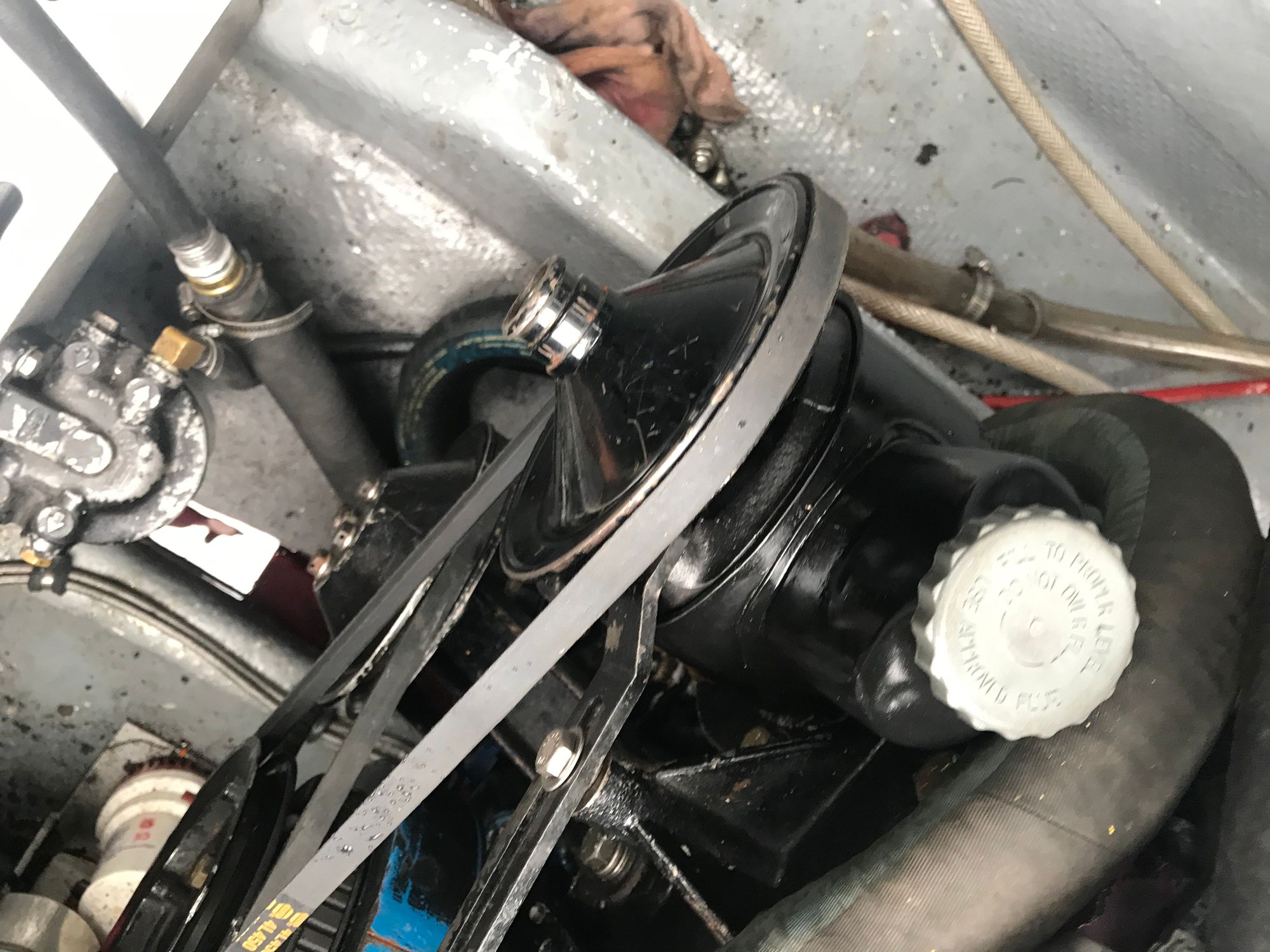

Subscribewwll I finally got power steering pump hooked up and ran it for a while all good, then all of a sudden it starts like boiling out of the cap filler like a volcano erupting and just keeps flowing, what the hell is going on? I’m so frustrated. Help I’m at my wits what is causing this now

how did you bleed the system after installing the pump
- I undid nut on both lines and also turning it to, just idling and not even turning anything it just starts erupting out of filler cap like a volcano. I’m wondering if my lines could be crossed cause they go from pump and under engine and thru then back of wall of transom . You can’t really see under engine to tell. Would that cause it to erupt out maybe

post pics of the pump and reservoir bottle
