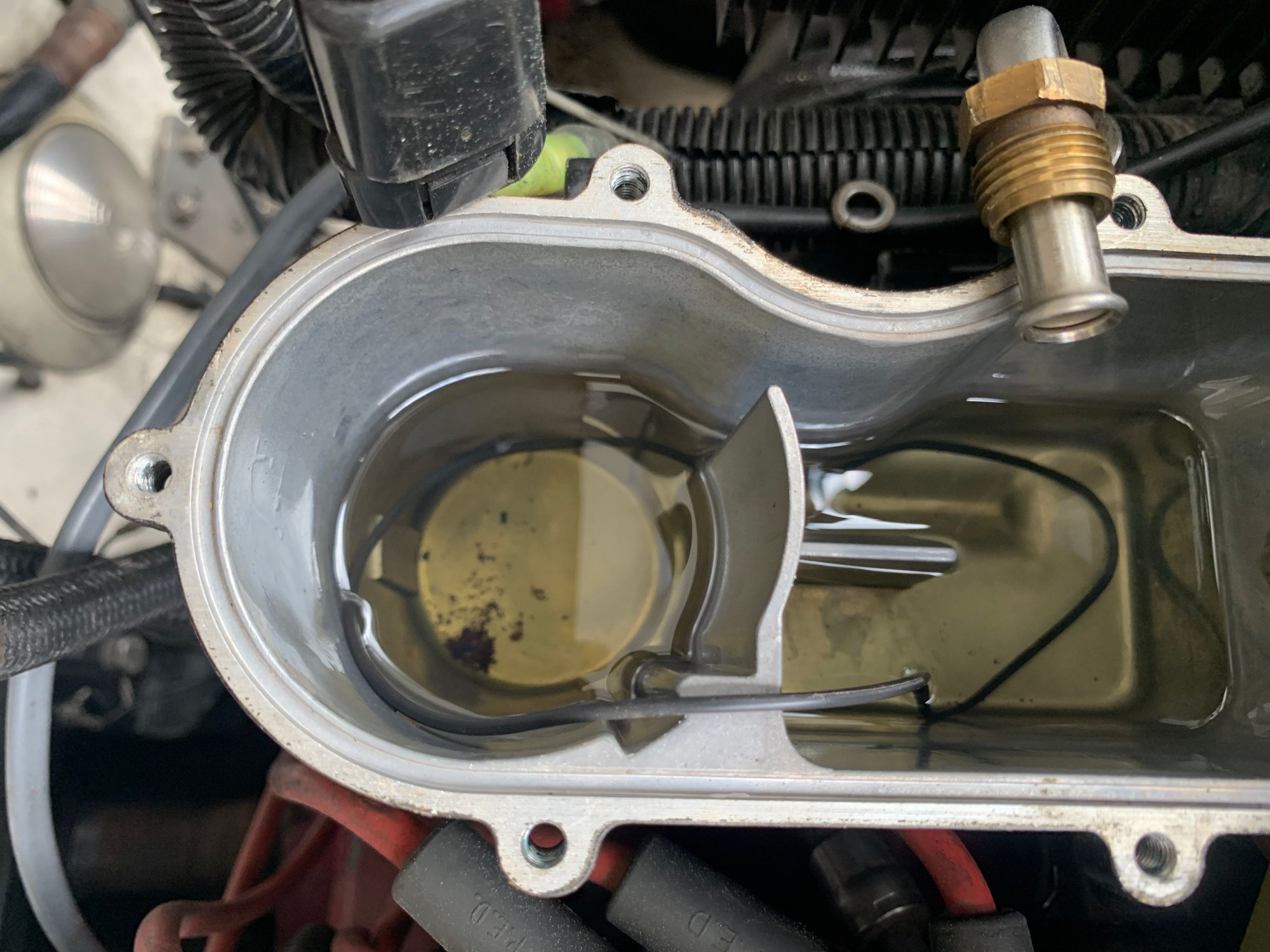

i pulled the screen and there’s nothing in the filter. Do I just hit it with carb cleaner? But they’re was some debris in the VST tank itself I don’t know if it’s enough to cause the issue. How can I check if it’s the regulator? The holley systems are fairly new.
