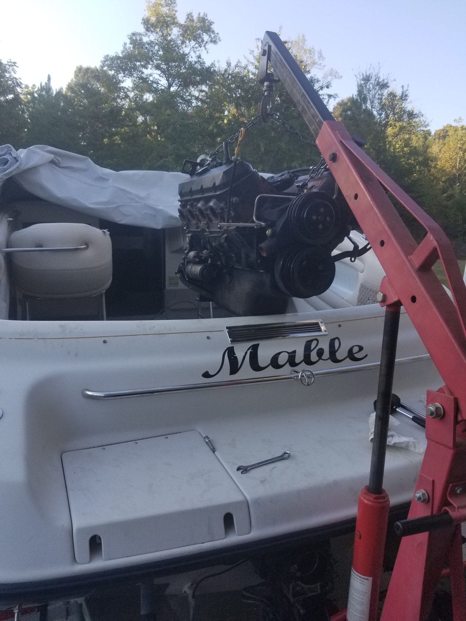

To be current I decided to update this thread. I found a deal on two 502 mag mpi gen vi motors. Both had water intrusion. #1 was said to be running and probably head gasket or intake gasket leaking and no other problems. I opened the engine had the heads pressure tested and put it back together. The engine looked great on the inside like new. No metal shavings and just immaculate, # 2 was locked up with water intrusion and was said to be something on the exhaust. After looking into number 2 I found a broken valve spring and valve guide leaking water in the exhaust. Number 1 I never could fine a leak. They had decided to replace both motors since this had happen. I got a good deal so I bought them with the intention of upgrading my 454 mag to a 502 mag. I put #1 in the boat and was going to rebuild number 2 with performance upgrades. Once the #1 engine is in the boat it sounds amazing outside but has a tick that i thought was a valve clattering but now believe it to be a spun rod bearing. Ill post the link below to listen and get your opinion. Im still not confident its a rod bearing but the tick requires the engine to be pulled back out and looked at.
Now the plan is to make one good motor out of the two. I got #2 apart and the crank looks good. If everything works out Ill use the crank from #2 in the engine of #1 that is in the boat since I know everything else about #1 seems fine. Long way around this but I was truly hoping #1 was as it was stated....good. Lesson learned never take someone word for it. I should have just spent the money to rebuilt the engine while I had it out.
