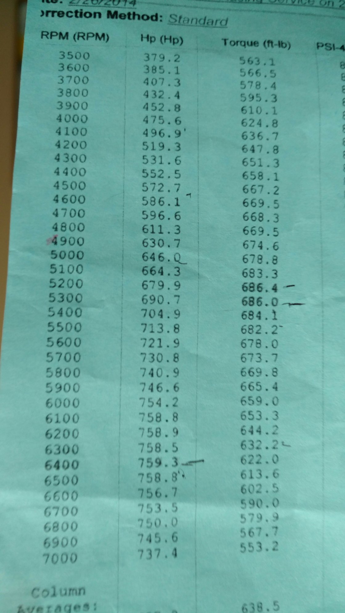

Originally Posted by KWright
565 cu in, 750 hp.
They look good but do they help or hurt power?
That would depend on what you are comparing them to
565 cu in, 750 hp.
Are those 02 sensor plate something you had machined or is that available from a vendor? How do they affect the fitment at the transom?
we made them up at Island racing. Put a small wedge in when running them in the boat to compensate for added height.
don't have a honest answer to that as we didn't run any comparisons. I'm sure we left some on the table with them but we were happy with the results.
