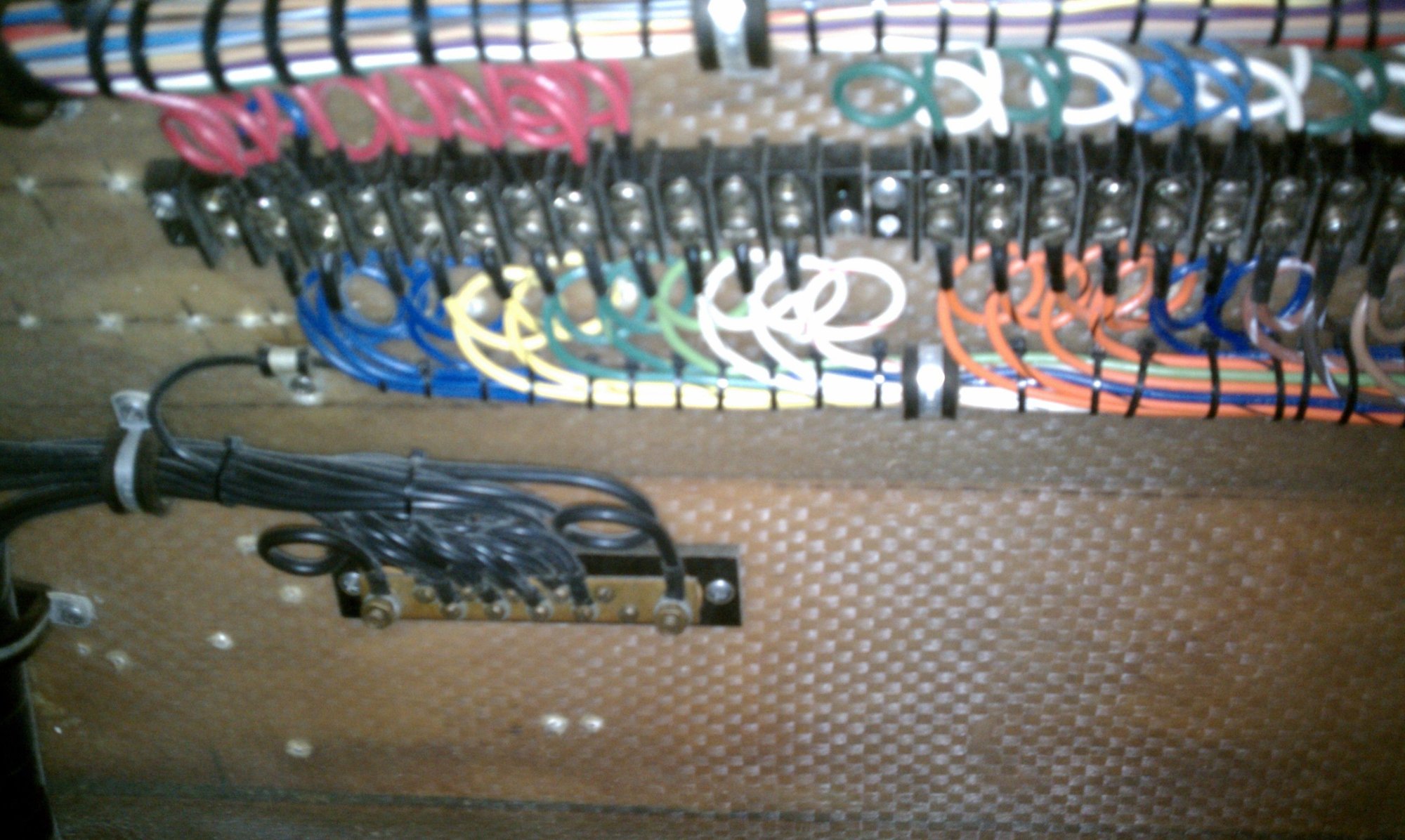

bck 12-21-2019 11:09 AM
I'd get a digital multimeter capable of volts/ ohms which can be found cheaply and will allow you to check everything out. See what the voltage is right at your battery, see what it is at the fuse block and at the gauge itself and anywhere else. There is likely a strip of metal in or near the dash wiring with lots of black wires going to it. Frequently smaller black wires coming directly from the components with one or two larger black wires running back the battery/ engine compartment area. You should be able to check all your grounds right at that strip. Use the ohm meter or a test light to check them.
bck 12-21-2019 11:49 AM
https://cimg9.ibsrv.net/gimg/www.off...247f26c2f6.jpg
Here's mine. The black wires are all my grounds. I expect you have something similar. I find it easiest to test them with a test light. If anything seemed suspect I'd switch to the meter.
