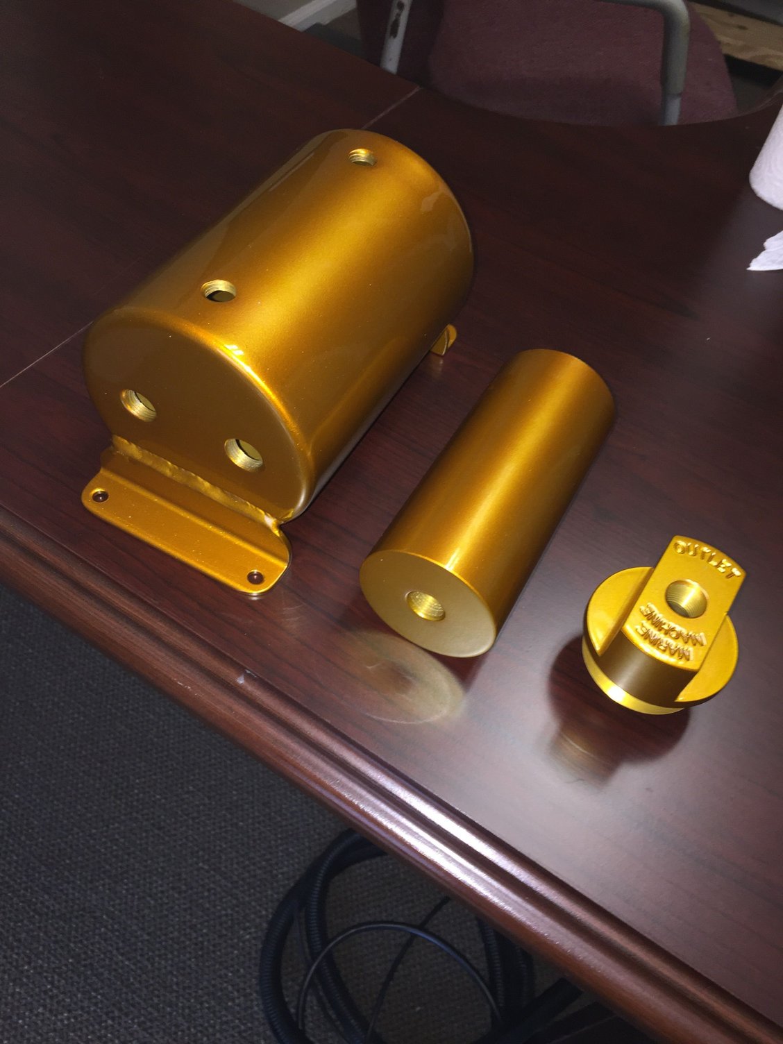

I should have been more specific. For the fittings for the tank and filter. My bad.

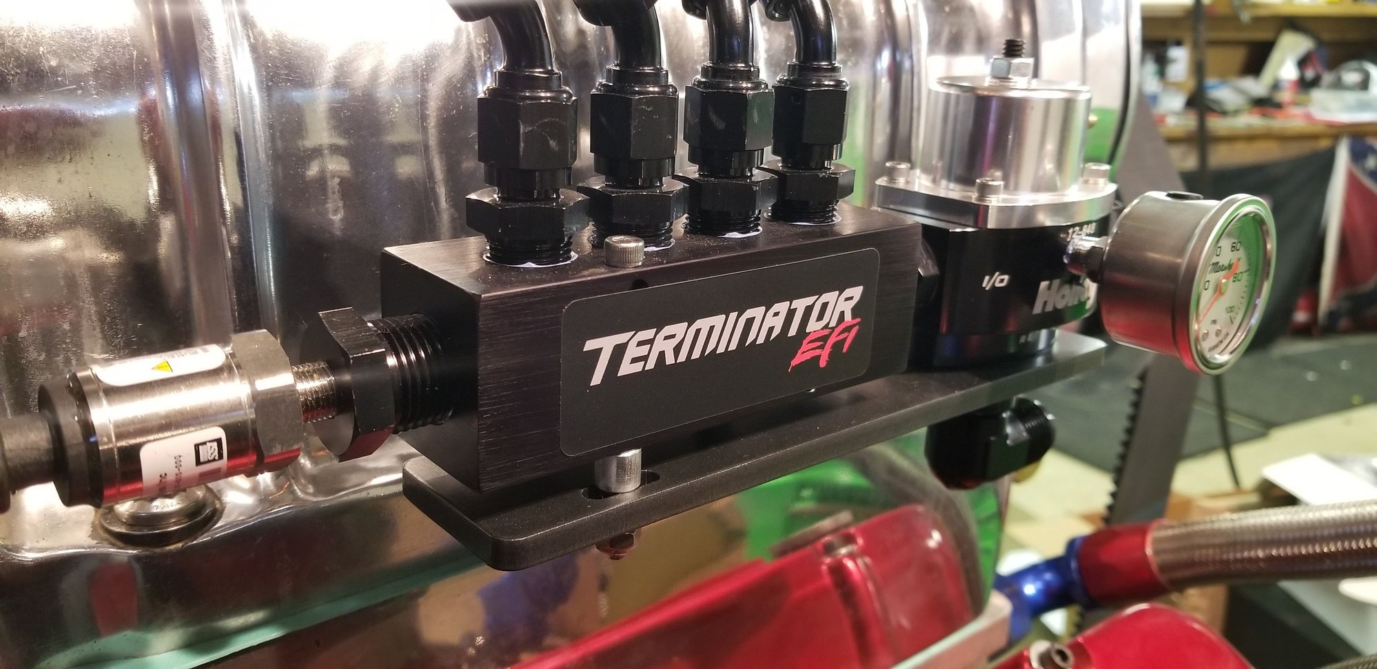

Whenever I`ve used any kind of paste on AN connections I get leaks, (leak lock included)
Switched to Blue monster tape and no more leaks, sometimes I use both tape and little bit of plumbers paste.
Found that to works the best in my HVAC /plumbing field too.
used paste on all the connectors below and they all seeped, used tape no issues. not sure what I`m doing wrong
