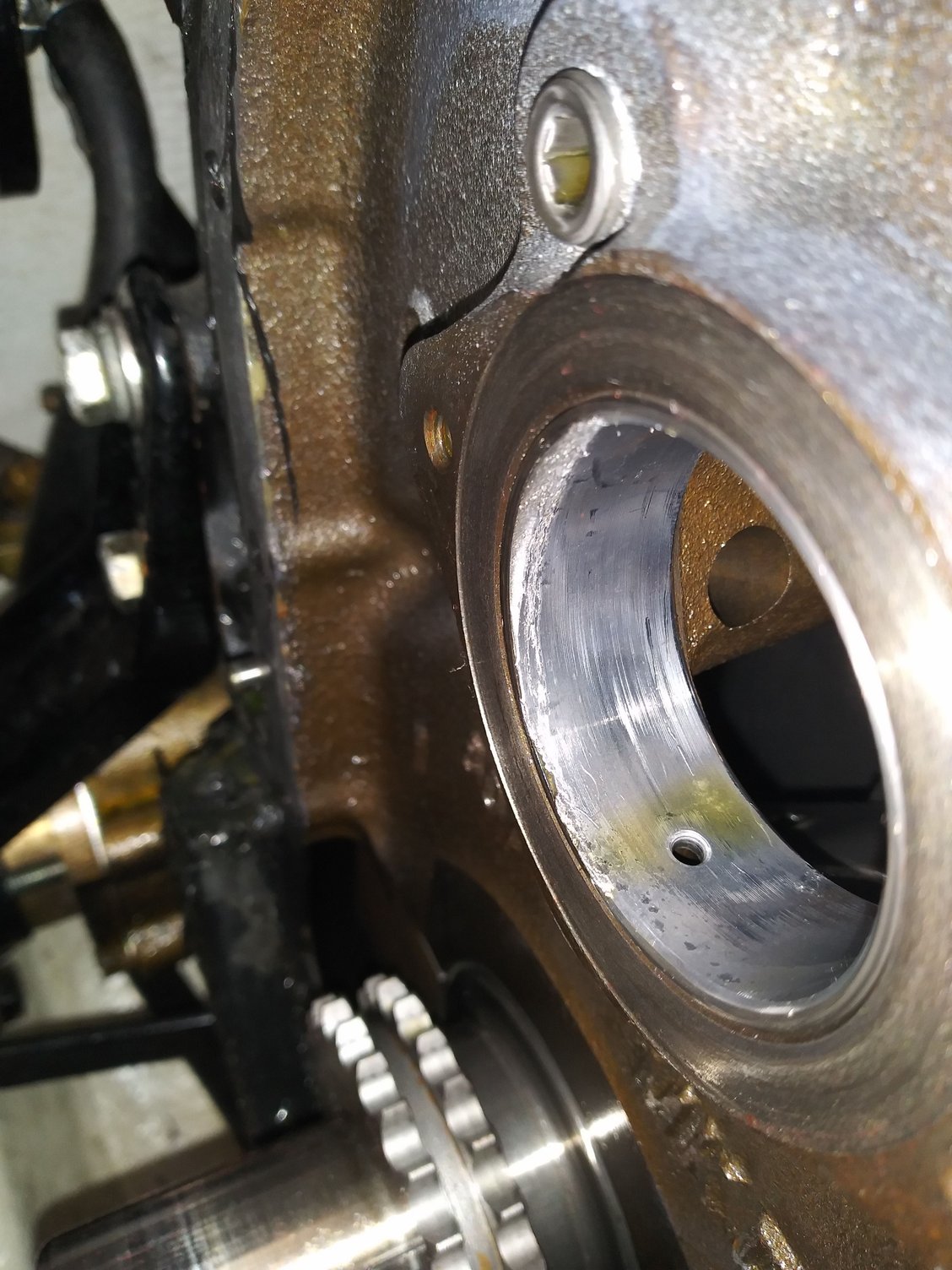

Thanks! That pan is flash gordon. What cam, lifters and springs are you using.
to add insult to injury i found this when pulling the other cam out. Explains why there was no front to back
play in the cam
play in the cam
ohhhhhhhhhhhh,,,
you using cam button or ???

Originally Posted by flashgordon
ohhhhhhhhhhhh,,,
yes has cam button. Pretty sure this ones on me. forgot to grind the water pump rear cover bolts down. See when i head back to the lake this weekend.
if u are running solid rollers , like i am,, u must sure to check gap or fore to aft play in cam button to timing cover.
it took me some time , but finally got what i think was 010 to 015 gap.
yea , used 3-4 water pump gaskets,,,also had to grind down bolts on backside of pump.
i had to do this stuff , as it was a new setup for me.
what did u do with cam bearing???
