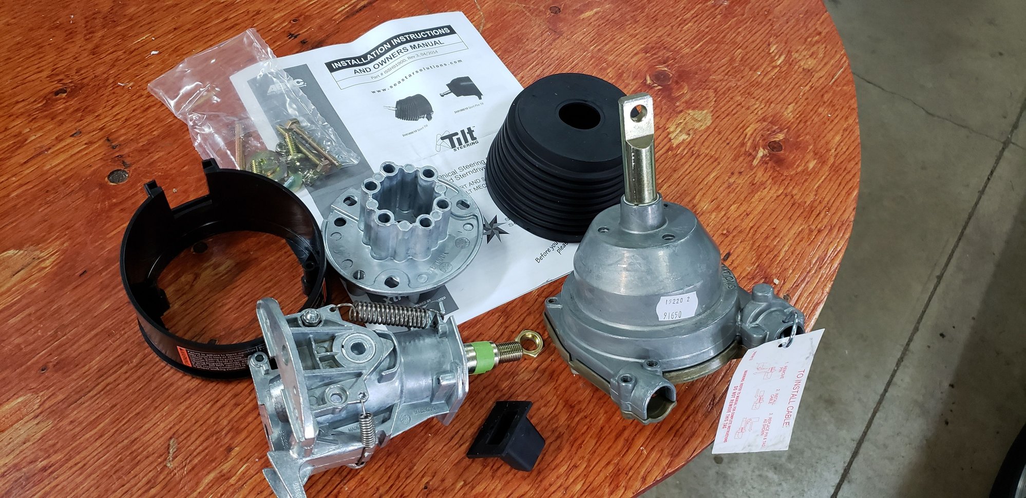

Guy calls me back about a tilt helm. Says I could use the "high performance" Seastar SH91650P helm and the SH91800P tilt mechanism. It's almost twice as much for the whole kit which includes the cable as the first solution, I dont care too much about that, the tilt would be nice. Anyone with experience with this set up?
​​​I'm replacing my tilt also from a 2006 formula sunsport 28-foot with feedback steering dual outdrives. The only reason I'm replacing it is because the shaft in the tilt helm was loose. I talked to seastar and they have repaired that with a bearing instead of a plastic sleeve so should be better.
