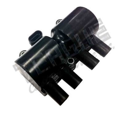

So, looking at the pic from your link, I know I have seen that exacr coil pack on a vehicle before. Hmmmm. I’ll hit a catalog or two and see what I come up with.
Merc part is $275-325 dep on dealer
Here is photo from Merc

Okay, I’m done looking up.
AcDelco part could very well be Delphi, but you never know now a days. Take a look at top and bottom of your coil and let us know of any manufacturer name, letters, symbols, numbers.

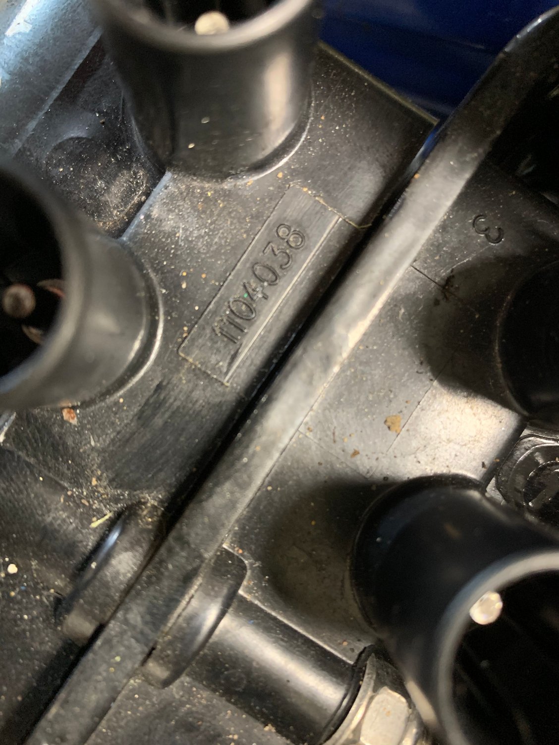

Not sure if this number helps, this is off my 2004 vintage 525. The coils of my 2008s have the same numbers on their coil packs.
SB - Nice research on cross referencing parts sir. Great info
Sweet. Thanks for help on deciphering these.
