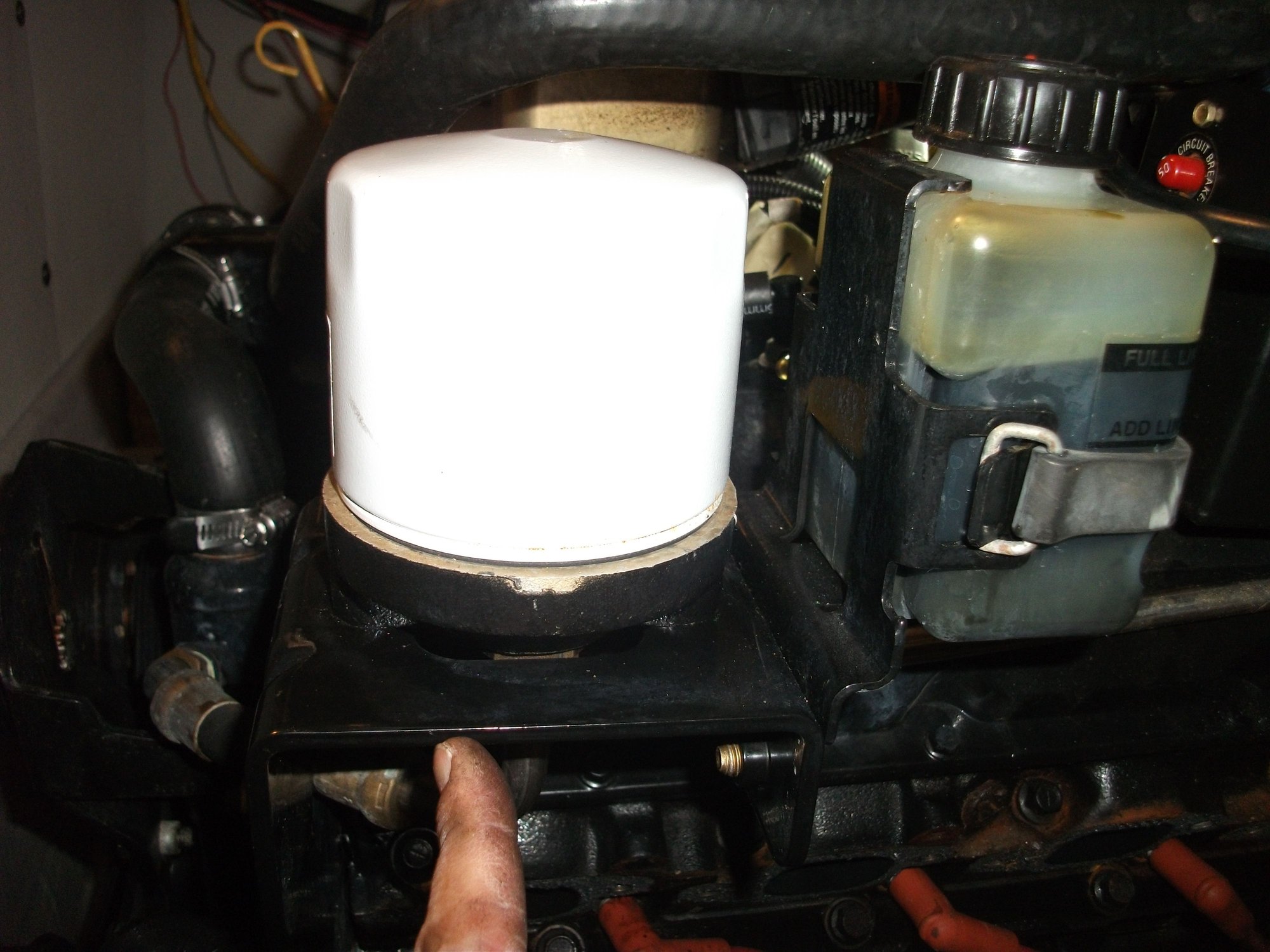

So you guys have given me an idea. Cut the mounting bracket and bolt a piece of SS to the bracket that's left and mount the filter to that. This should move the oil filter mount forward almost 3". I think that would clear.
The out drive reservoir can be relocated to the transom easily.
Then run new hose from the oil cooler and to the block.
Question though. How do you address a "U" turn from the engine block oil location with AN fittings?
And what size hose and fittings are the oil lines?
I plan on using braided hose and aluminum AN fittings.
Relocate it to about here
Cut the bracket here
xlint89 is offline

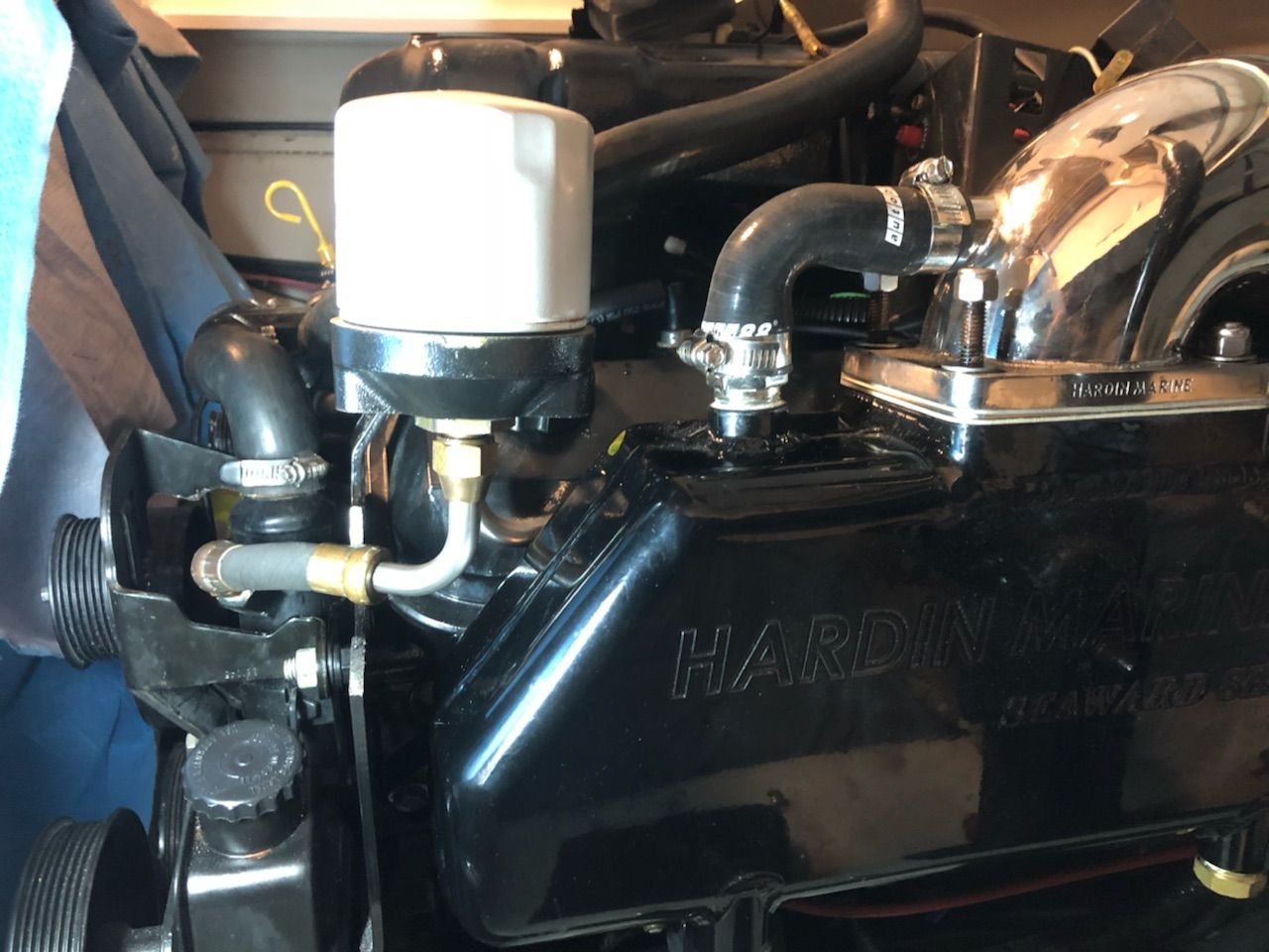

Because of your guys input, I think I got this.
Went from this
And this
To this
This
And this
xlint89 is offline
Old 05-30-2020 | 10:29 PM
Joined: Mar 2020
Posts: 841
Likes: 494
Don't have to change oil lines.
Removed the bracket. Loosened the oil filter nuts. Loosened the oil cooler clamp and water hoses.
Lifted the cooler up a touch and spun it a little bit too.
Spun the filter housing so the lines would orient themselves without having to rebend the hoses.
Will need to make the bracket, but that's easy. And relocate the out drive reservoir That's easy too.
