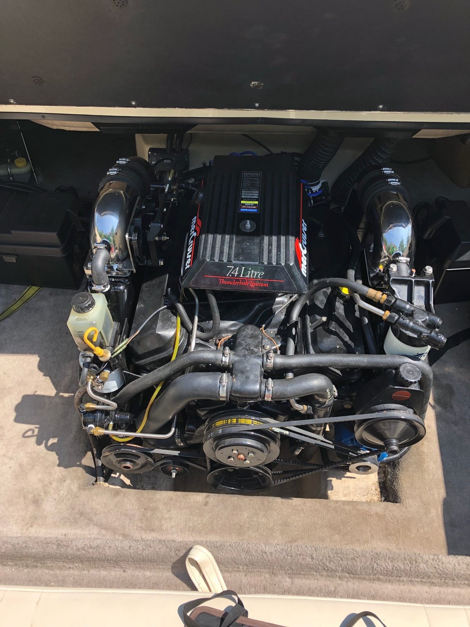

Post up a pic of your engine please. Would prob be able to see any fitment issues just by looking. As i wrote before, no problem with the 7.4L in my Bryant. This boat, need to move some things around.

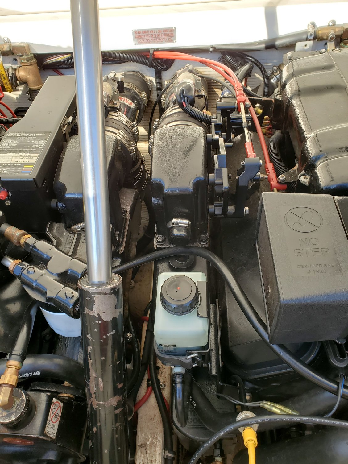

nygman11 05-10-2020 10:42 AM
https://cimg9.ibsrv.net/gimg/www.off...5d8c931ff0.jpg
https://cimg8.ibsrv.net/gimg/www.off...317814b7f9.jpg
https://cimg2.ibsrv.net/gimg/www.off...bcfeef3277.jpg
There is not a lot of room and I was hoping to keep every thing in the stock locations.

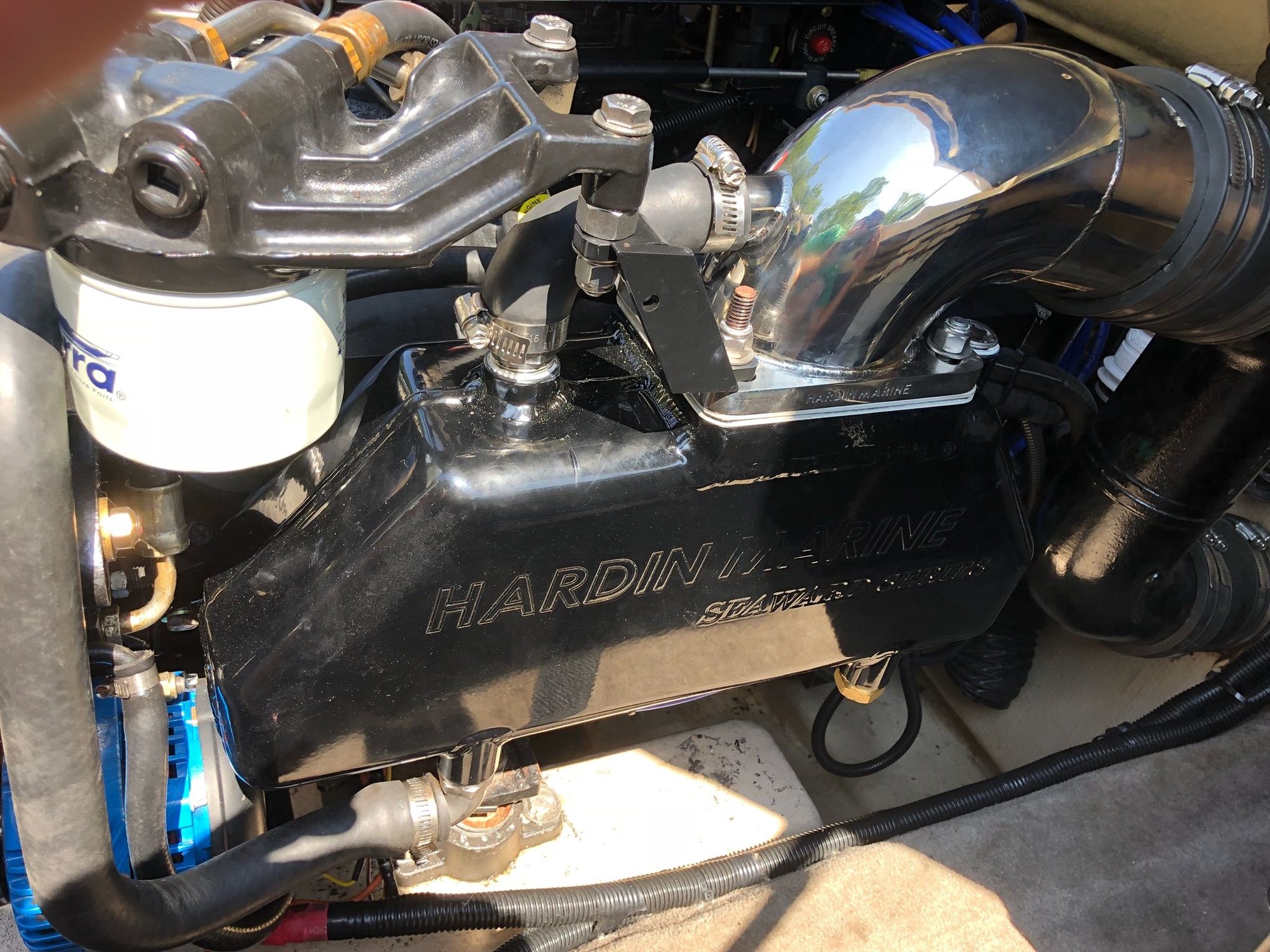

xlint89 05-10-2020 10:28 PM
You might need to modify the out drive reservoir location, but the oil filter locations would prob fit with the relocation brackets.
Here's how it mounted up on my 7.4L
https://cimg1.ibsrv.net/gimg/www.off...a4dc1c0ba8.jpg
https://cimg2.ibsrv.net/gimg/www.off...63ce2e1199.jpg
I'd go with stainless marine too, but, the cost of it is almost double. You can almost get 2 sets of Seaward for the 1 set of SS. And dam, those are purty...
