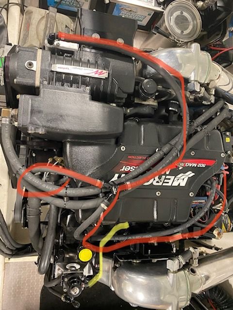

The ecu will need to be tuned to run proper afr's as the two added injectors will fire with the factory eight injectors all the time. I ran the fuel system like this. My original setup had no added injectors. I added the two 80lb injectors in the throttle body and yes it was super rich. My ecu is on its way back from young should be here tomorrow. I will let you know how it goes.
Red is fuel supply arrows showing flow. Yellow is return.
Tim
Tim
Thanks Tim. That is pretty much the way mine is done. Except mine goes through the fuel rail first then to the supercharger. I had my fuel rail modified so it has a return on it.
