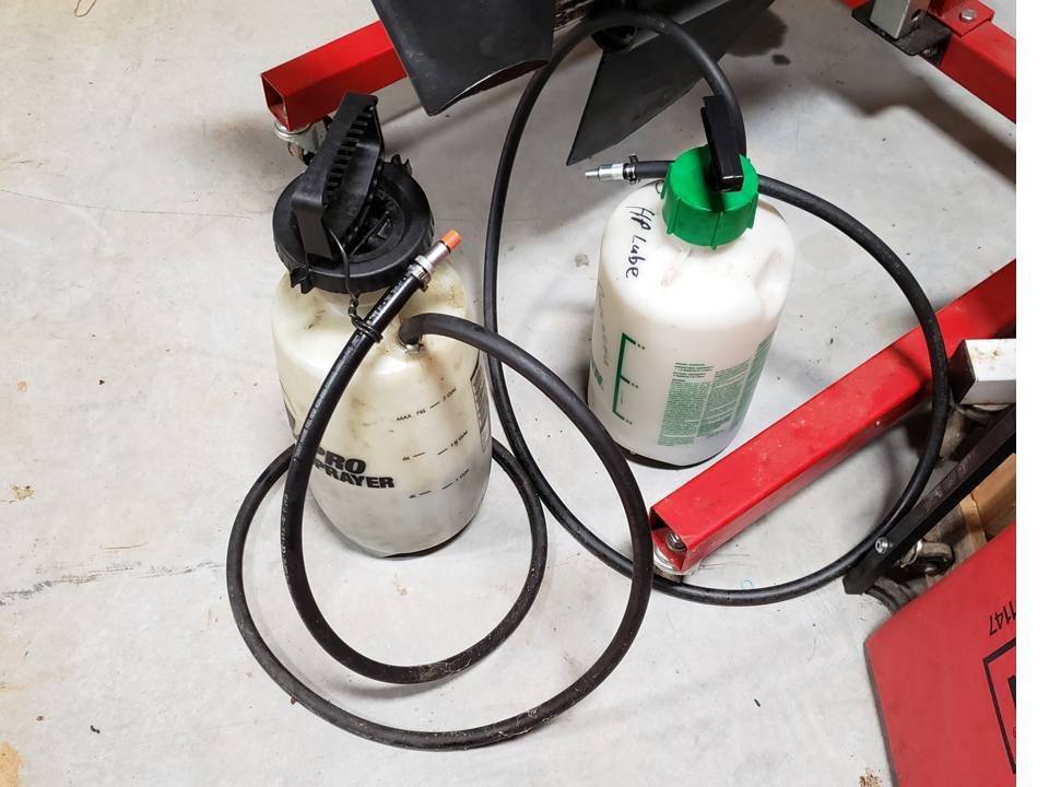

One on the left I've had for years and it use to have Merc HP lube, but shifted HP to the one on the right and put Merc new synthetic lube in the left. Used the fitting from the quart bottle pump on end of gas hose.
The big issue is finding a pump which uses a similar size line inside the tank as outside. Some of the new ones have only a 1/8 ID plastic tube.
Did just have to replace the rubber valves on the larger one this year because the lube took its toll on non-vitron, but hey it cost $5 for the new parts

AD how do you control oil flow? Install a shut off of just vent the pressure when full?

Garden sprayer here too. Mine has a pressure dump feature that's nice to have when drive gets full and starts puking.

I have a CDI one as well it sure makes it nice over that quart pump b.s... I bought a special machined "extension" adapter from Jeff @ Harris Performance that makes it even easier to do the Bravos than any of the ones it came with. Nice to know if the pump portion goes out I can get a new one easy lol.

Husqvarna pump sprayer at Lowe’s. Same pump
