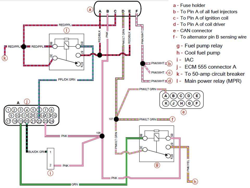

Can you tell me where the "main power" relay is located? I know I have a couple mounted on the bracket with the PCM but I am unsure what they are for.
Sorry, just noticed this
The MPR is next to the fuel pump relay and they are the same type and can be swapped
Look for wiring colors. The MPR will be the one with Red/Purple connections
