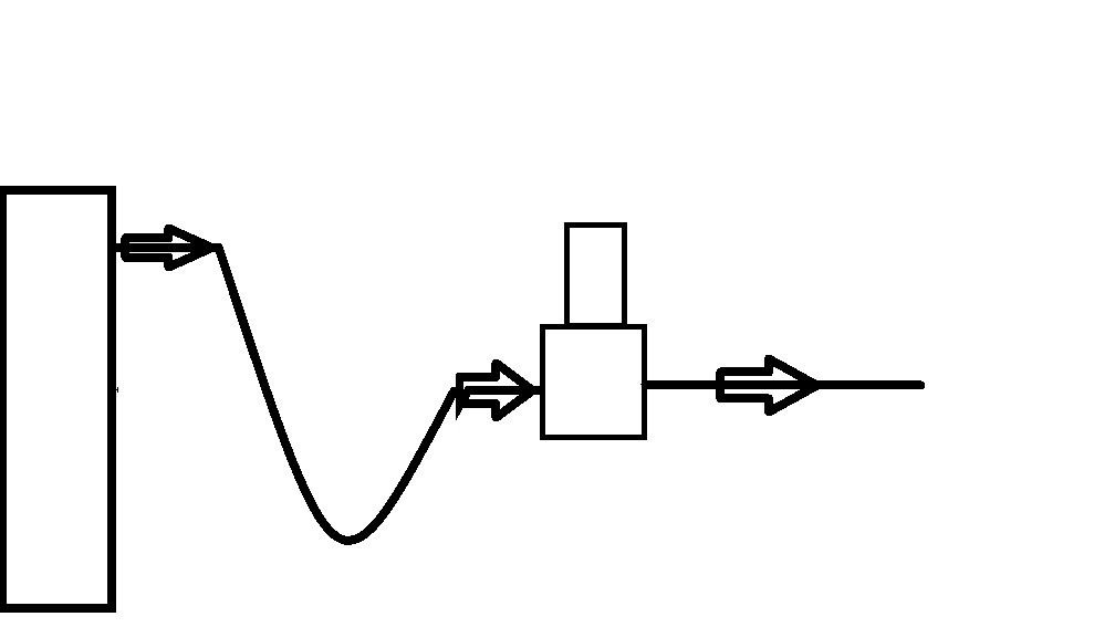

I run mallory 140's. This is what I did. I mount the pumps as low as I can in the bilge. I then run a loop in the delivery hose that will keep fuel in the line to allow the pump to prime and create a vacuum.
