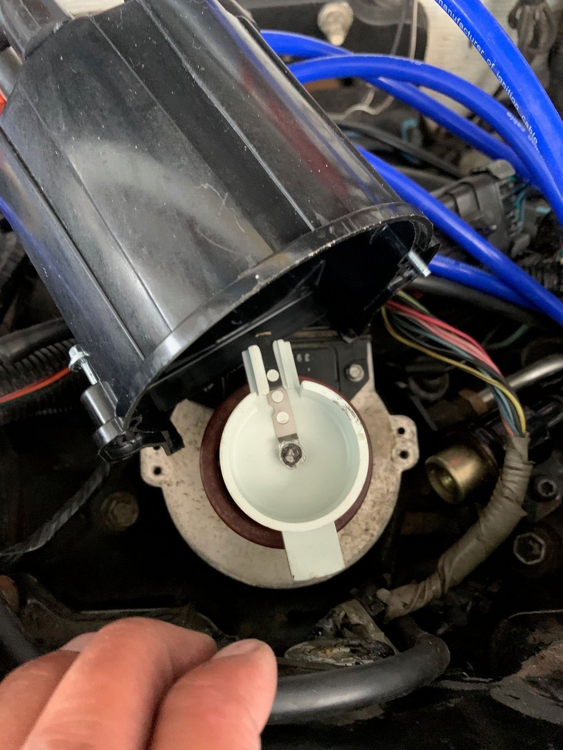

I checked TDC on plug 1 and the line on the balancer matches the pointer and the piston is at the top when I pulled the plug and checked. I pulled the cap and checked the rotor and the plastic tab is pointing to where the plug 1 wire is (between 5 and 6 oclock). Is the plastic tab supposed to point to 1? Or is the opposite end with the metal contact supposed to point to 1? I would think it wouldn't even start and run if the rotor was 180 deg off (if the metal contact part is supposed to point to 1) . Here's a pic of the rotor at TDC

where the metal contact is pointing now is to the wire for plug #6, which is 180deg from #1. Engine runs and idles great, just not getting advance timing so I am confused! lol

Looks like you're at TDC but on the exhaust stroke.
Turn the crankshaft 360 degs (in the normal direction) and check the rotor again. It will be pointing right at the #1 wire. The dist turns once for every 2 turns of the crankshaft.
