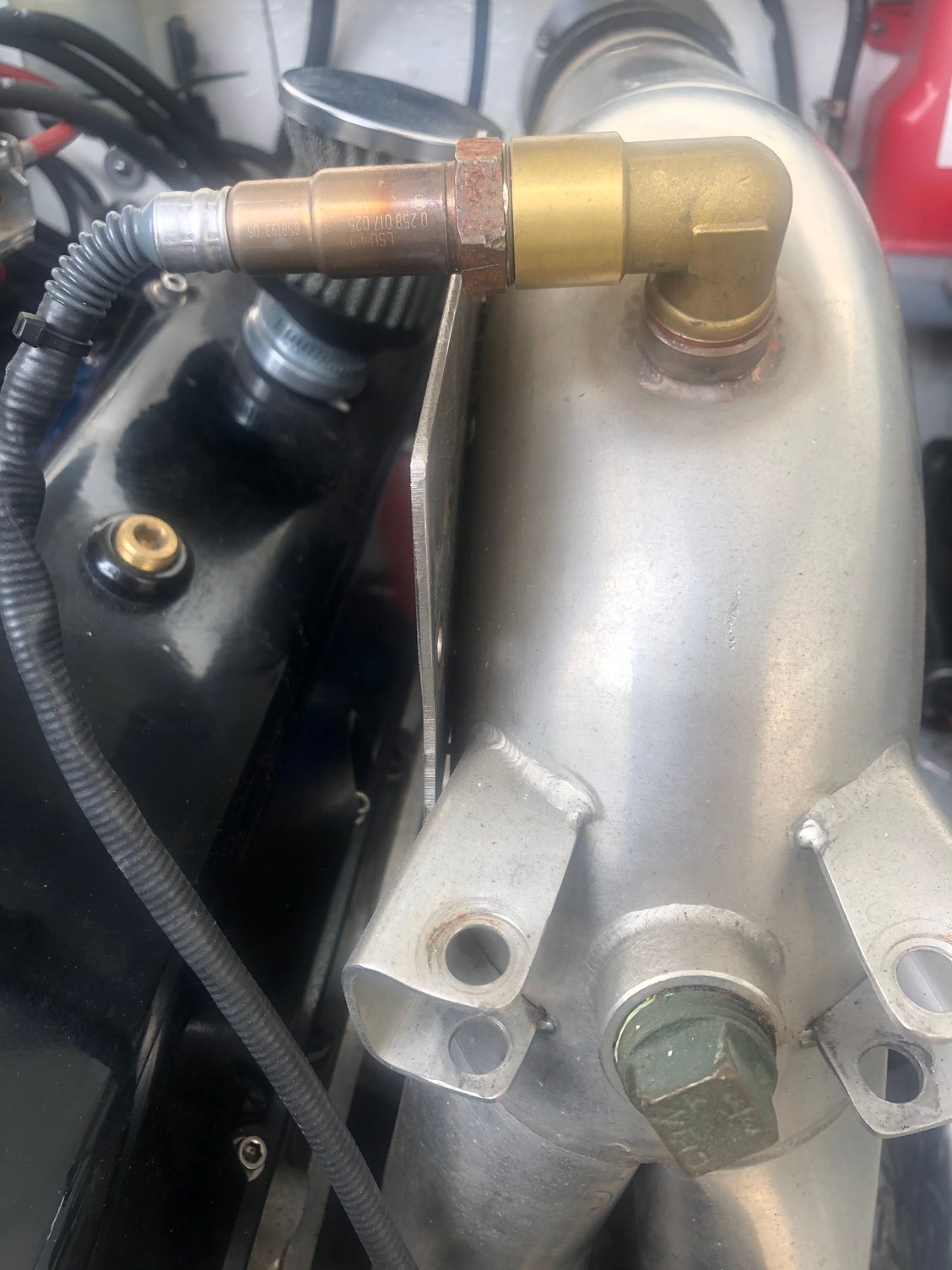

I’m using a 90° bung extender off Amazon with pretty good results. May be worth a shot before taking more drastic steps.
