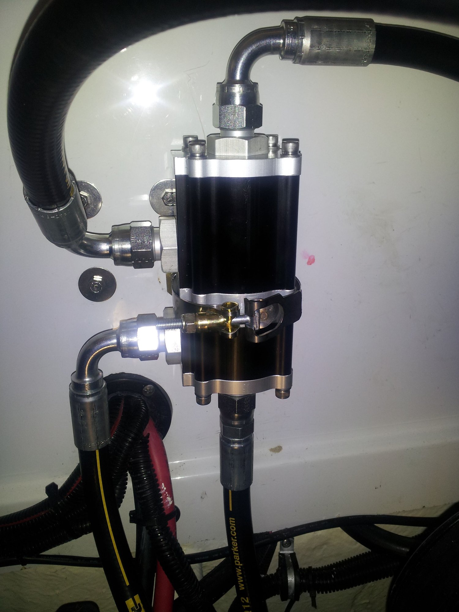

On my last boat I installed an external oil thermostat.
EDIT :
https://www.summitracing.com/parts/ctr-22-480
Made by Canton if I recall
