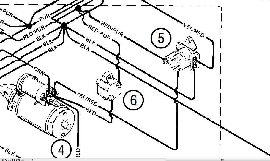

Your #3 means the solenoid is either wired wrong, faulty, or the ground to solenoid faulty. Last possibility, but more rare, yellow red from shifter neutral safety (goes to a lower smaller stud ) not enough power to enact this ‘large’ solenoid.
Use this to Double check your wiring too:
