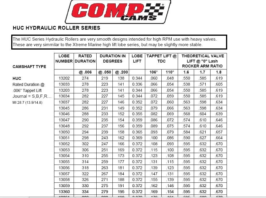

500 EFI cam 230/236 0.598"/0.610" LSA 112°
Call comp and build the cam. Lobe 13045 and 13048 LSA 112° Tell them what you are trying to copy.
Any specific reason for the 500 EFI cam? Or just replacing old one?
I just put 2 500 EFI cams in the 454's I built for my Panther. Seem to run pretty strong.
