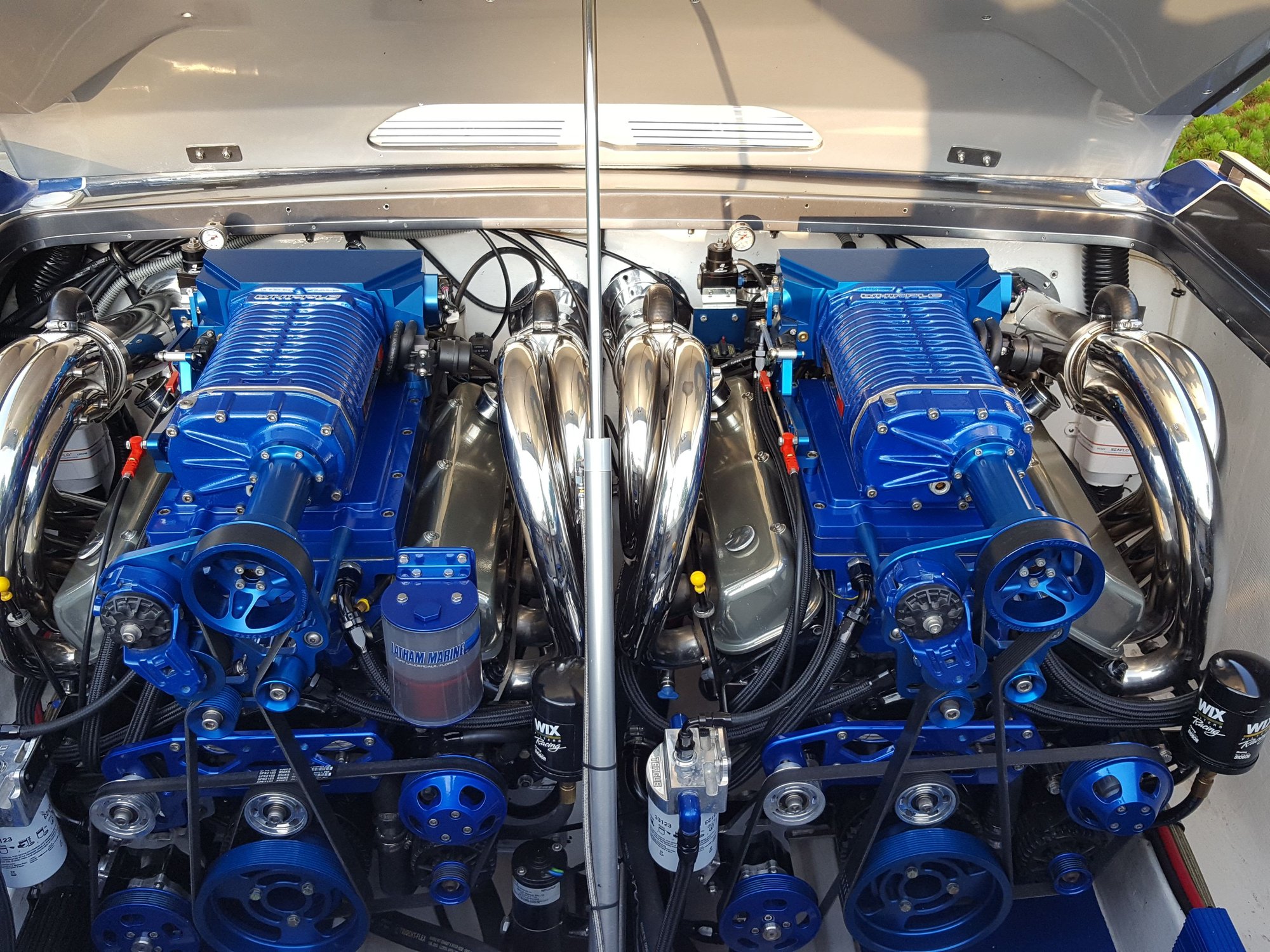

You don't need premium MT. Ethanol won't be a problem unless your fuel lines can't handle it, or you have a fiberglass tank.

you can run the return to the water separator filter head if you have a port available without issue if done correctly
Have any pictures of how this is plumbed in ?

The return goes in the top of the filter bracket, these are TCM units, this is per Whipples install guide
