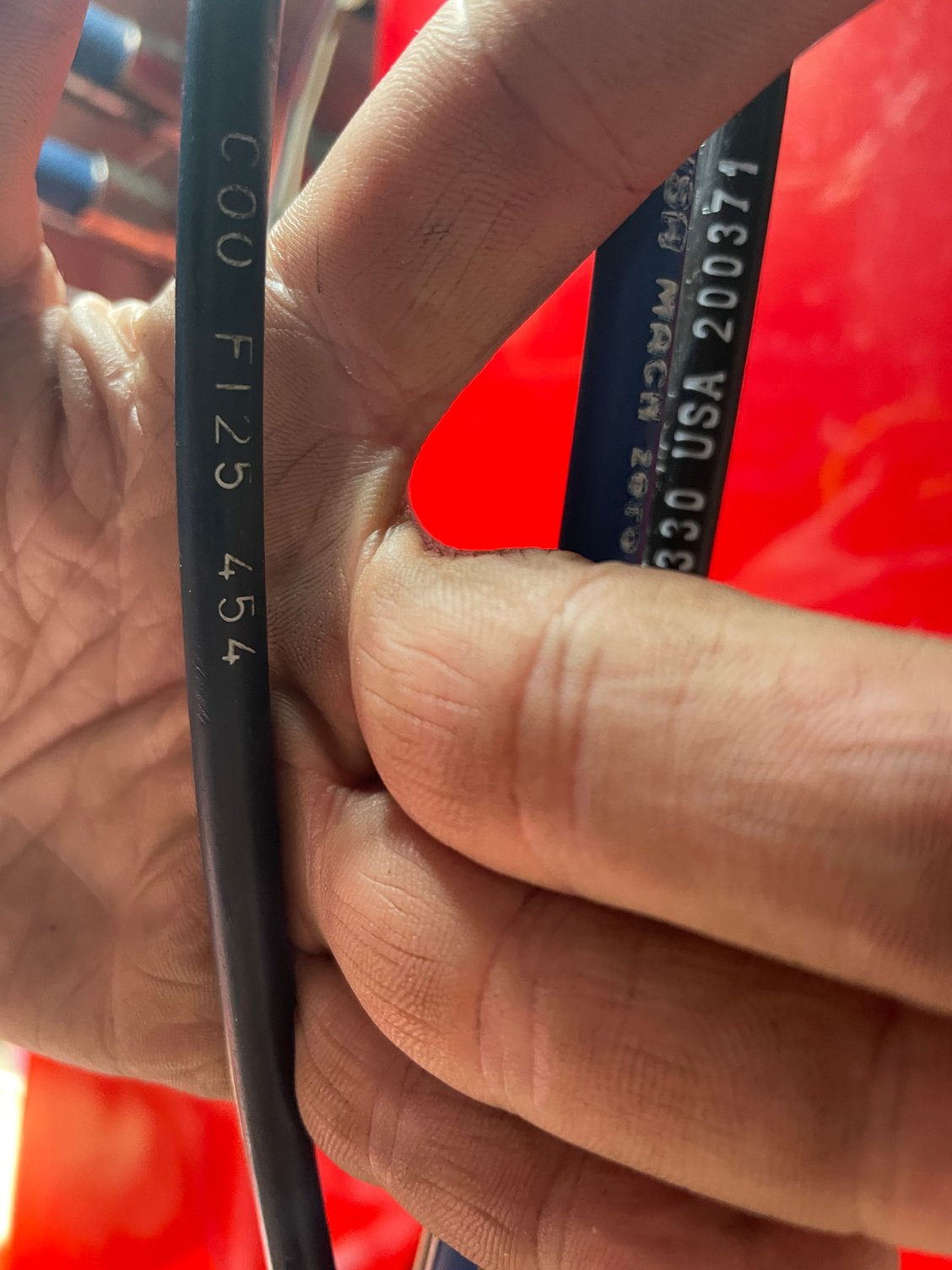

I need to replace the starboard trim tab cable and I'm having a tuff time figuring out what the length of the cable is. Here is a picture of the numbers on the cable but they don't make any sense to me. The cable need to be around 20-22'. Anyone have a clue what I'm looking at here?

Doing some more digging, I found.a used Ultraflex COO 122 cable on eBay. That cable is 22' long so mine must be 25'. If anyone else runs into this, hopefully this helps.

Pretty sure you are correct in yours being 25 foot. I know yours isn't for steering, but should work.

That is for sure a 25ft cable. I just replaced all of mine and had to learn the way to read the cables myself. I used the Mach Zero cables which were what came in mine originally.

Some of these cables are easy to figure out, others not. Either way, the new cable is ordered. Thanks for everyones help!
