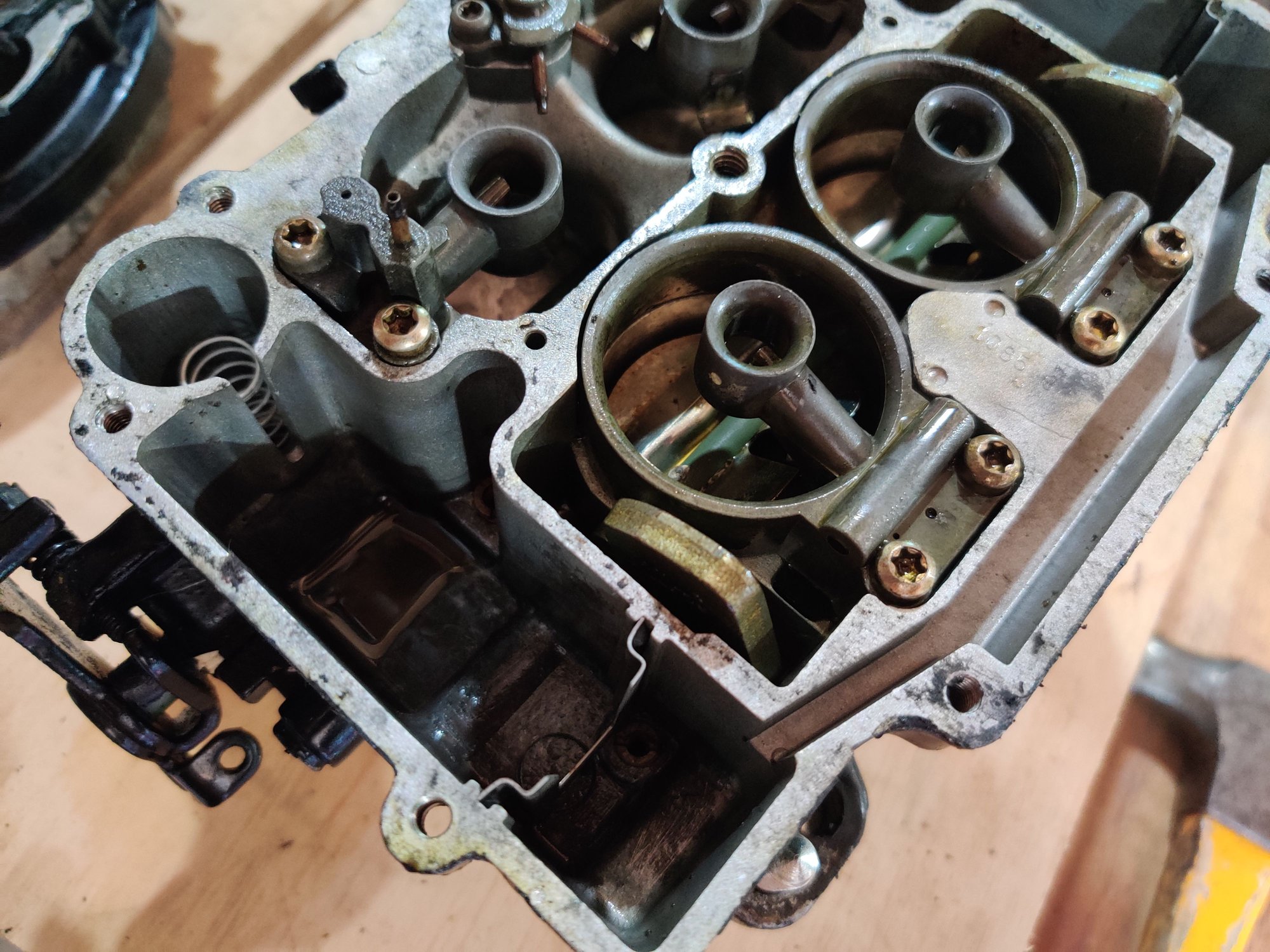

HawkX66 06-06-2021 02:32 PM
She's definitely not the dirtiest carb I've opened up, but she sure wasn't "just rebuilt" like the previous owner claimed. The primaries squirt gas no problem, but no fuel is coming out of the secondaries. Rebuild kit will be here Tuesday...
https://cimg7.ibsrv.net/gimg/www.off...a51c466043.jpg
https://cimg1.ibsrv.net/gimg/www.off...8836bcb66c.jpg
https://cimg5.ibsrv.net/gimg/www.off...736ad4d8c8.jpg
https://cimg0.ibsrv.net/gimg/www.off...779dbbb5a5.jpg
lol
Acc pumps on vac sec carbs squirt fuel into primaries. How did you determine no fuel getting to secondaries ? Just don’t want you chasing a nothingburger. :)
