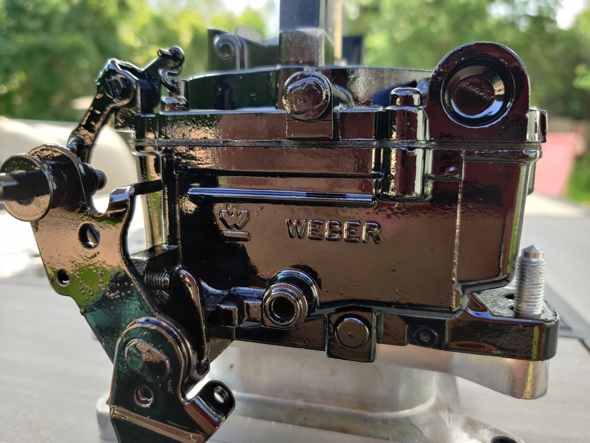

Acc pumps on vac sec carbs squirt fuel into primaries. How did you determine no fuel getting to secondaries ? Just don’t want you chasing a nothingburger. :)
Good catch and point! Either way I wanted to rebuild the carb. I didn't trust it. I'm going to rebuild the carb, refill the a/f and double check the timing to see that it's where it should be and not advanced. I'm also going to still install the clear tube for good measure.

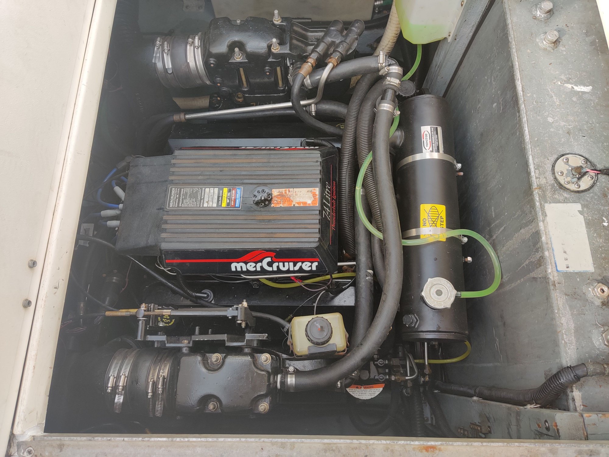

HawkX66 06-16-2021 11:00 AM
Rebuilt the carb and refilled the a/f. The guy at Monitor said he thought I had air in the closed system. It's running excellent except for the heat. I let it idle with the cap off for 20 min. It burped a little once, but not as much as I'm used to seeing on a car radiator. The temp stayed at 210 the entire time once it warmed up. One end of the heat exchanger stayed a little cool, but the rest of it was 207. Risers still cool as well as the exhaust water out the drive. Monitor said if the water coming out the outdrive is cool that I'm getting plenty of raw water for cooling. The problem IMO is with the heat exchanger. Emailed them yesterday, but nothing yet. I'll try calling again.
Here's a vid from yesterday.
https://youtu.be/KekmU_mr6PA
https://cimg1.ibsrv.net/gimg/www.off...50023a103c.jpg
https://cimg7.ibsrv.net/gimg/www.off...9a80aa8816.jpg
https://cimg1.ibsrv.net/gimg/www.off...12fb2c9856.jpg

HawkX66 07-03-2021 01:11 PM
All fixed. Yesterday I pulled the risers and elbows off. Monitor wanted me to replace my lower bronze exhaust 90* elbows with their copper ones because they flow better. Before I did that I figured out what was the real problem. Monitor suggests putting the top coolant fitting in the riser, but doesn't say you have to. Mine was still in the top of the manifold. I think it cause an air pocket or something. Either way, I'm running at 160*-165* and all is right with the world finally.
Thanks for all the suggestions.
