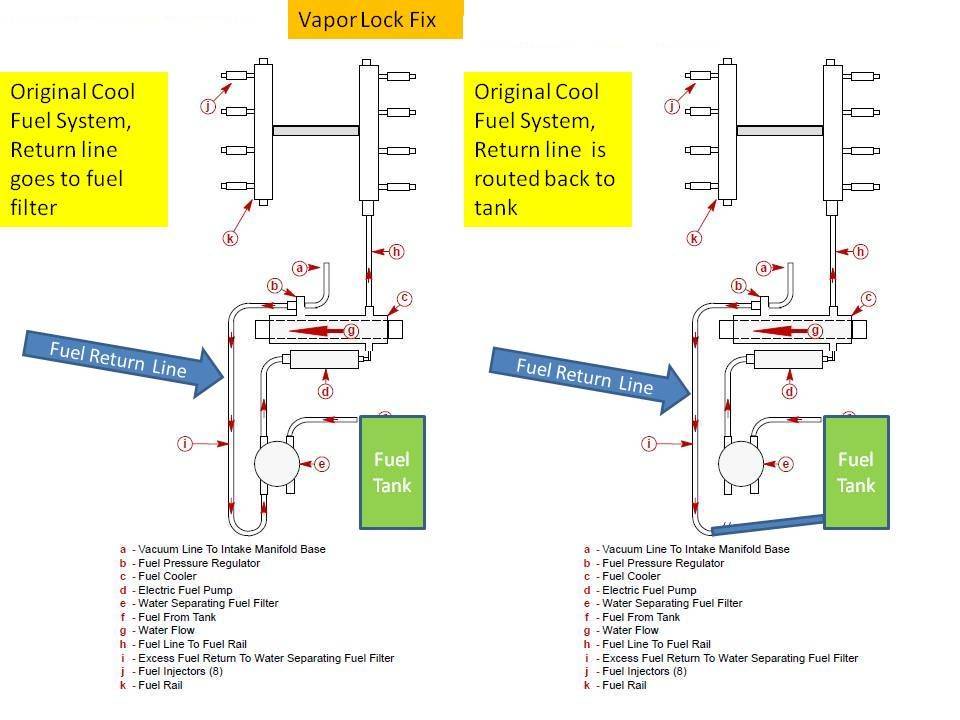

I had VL and fixed mine by moving the returning fuel filter and moved it to return to tank. My return came from the fuel rail and not the cool fuel Reg as in pic below. Eddie Young did the fix
