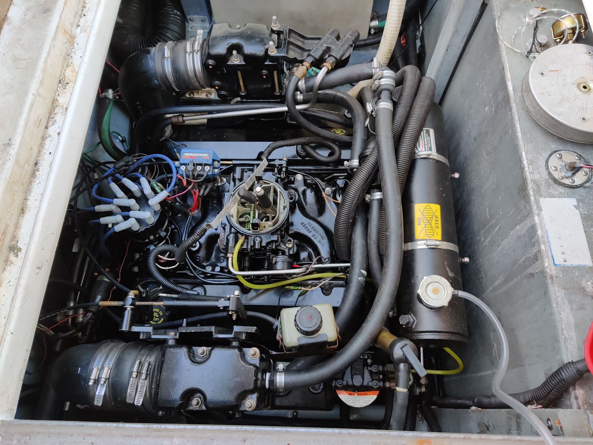

Griff 07-07-2021 10:40 PM
Originally Posted by TomZ (Post 4796265)
Guys, I having my CMI tails setup for O2 bungs. I tried doing some searches but didn’t get anywhere.
What side are you installing O2 sensors? I’ve seen a couple people reference doing the odd bank but with a single plane intake #8 is the farthest away. Does it matter? I have twins so maybe even on one, odd on the other?
Either way, looks like I’ll need to have them inline with then water inlet. Not a lot of room. Pic below is pre-carb builds.
Thoughts? I’m headed out shortly to drop off pipes.
https://cimg9.ibsrv.net/gimg/www.off...a4f3caa1e.jpeg
Nice bilge:ernaehrung004:https://cimg6.ibsrv.net/gimg/www.off...3cfcaafabd.jpg
TomZ 07-08-2021 12:56 AM
That looks familiar… Wish I had that room up front!
Little different now….

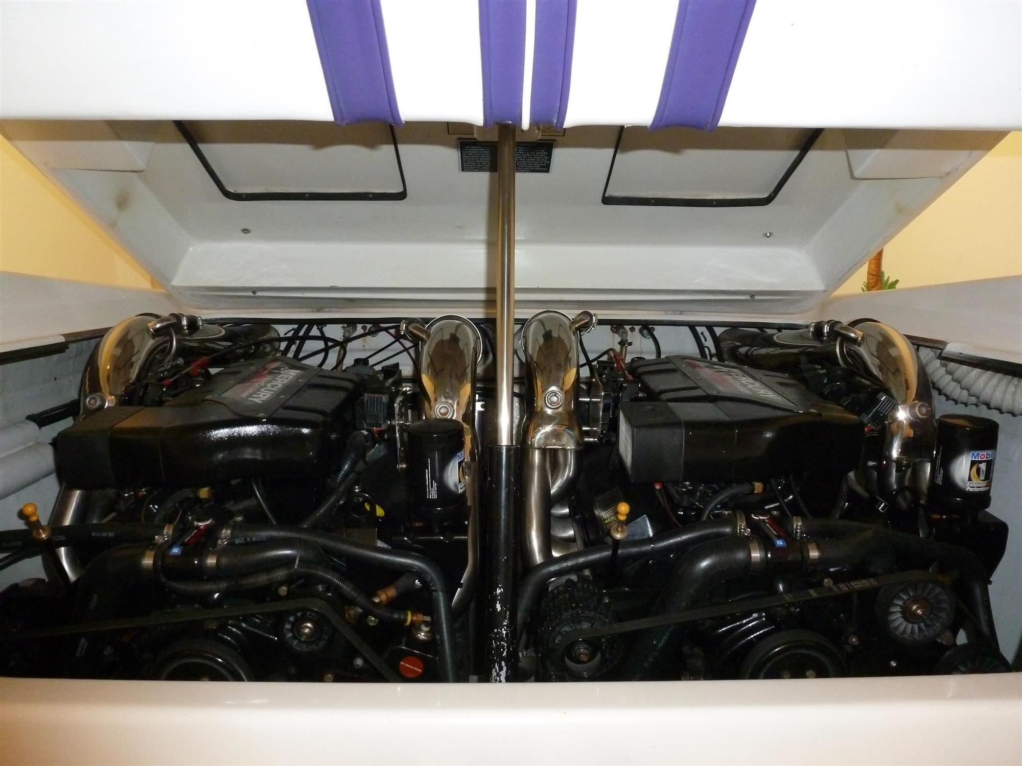

HawkX66 07-08-2021 07:06 AM
I don't even want to hear you complaining about room up front Tom lol
https://cimg1.ibsrv.net/gimg/www.off...ec7dd644df.jpg
TomZ 07-08-2021 10:04 AM
Yeah, you’ve got me best there… That thing is stuffed in there!
