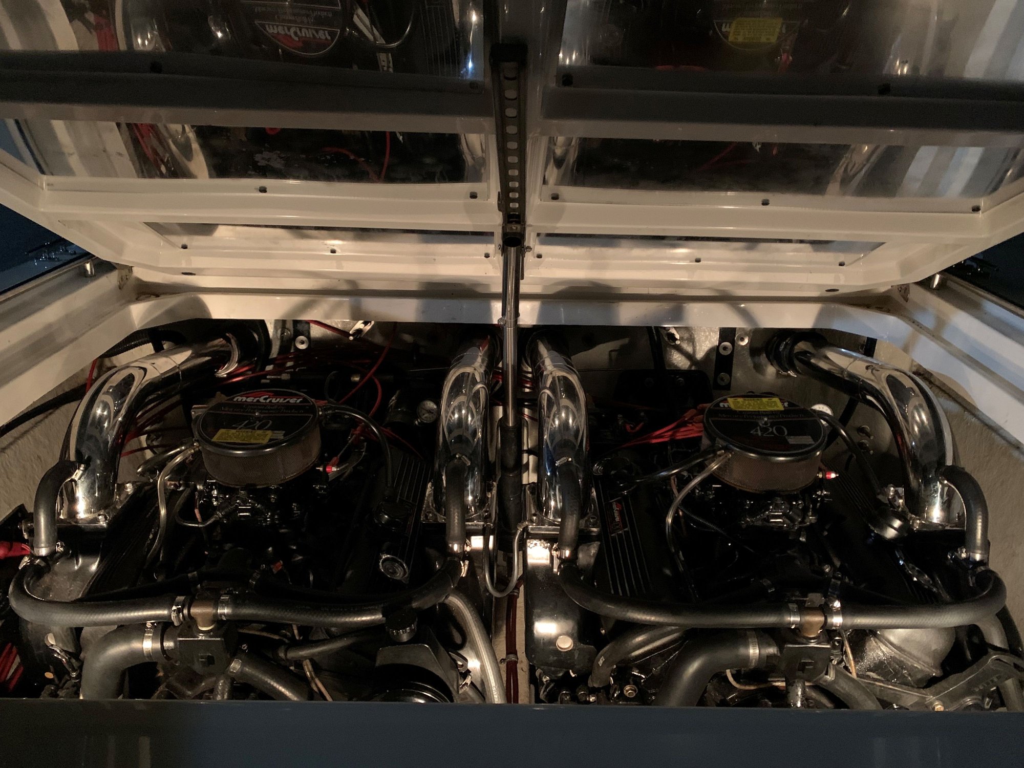

Speaking if which, what kind of cooling system ? Got a pic of your engine together in boat ?
distantthunder 07-12-2021 04:33 PM
Originally Posted by SB (Post 4797111)
Amongst of othering else, I’d check inside engine mounted water pump too.
Yes, all standard Mercruiser 420 cooling system. The only modification I did was removed the factory installed mufflers off the TRS tails over the winter and extended them to the transom, both inner and outer pipes.
https://cimg9.ibsrv.net/gimg/www.off...eb7df36712.jpg
Now, after digesting the events of the weekend, I was able to run for a few hours on the Chesapeake Saturday and only a very short amount of time on Sunday in my local river.
When running in the bay on Saturday, engine temps we lower than I typically see here locally and were around 150 on the old VDO gauges. On Sunday, temperatures on the gauges were in the 170 range as I typically see when running on the river. Our river temperatures are upwards of 85F this time of year.
This may not be the cause but does point to a cooling issue.
