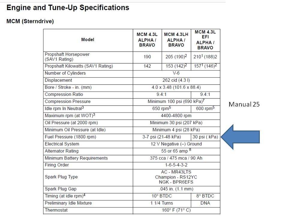

Originally Posted by KennethF
That what I was thinking too, but according to specs I found on the net for my engine it should run between 9-12psi -- 18 is max..

Purchased boat from another user 3 years ago with the engine "rebuild". Could be they did not wire vacuum hoses correctly but ironically it worked for 3 seasons this way.. TBH I always felt engine was to small for acceleration on this boat.. This summer decided to lack of power during acceleration, could be that the pump or pressure regulator got busted now..
If the engine is supposed to have 30psi fuel pressure it surely has to be a pump or regulator so need to check these on Monday.. but vacuum lines not connected in the correct order would make sense for loss of power at a different speed.
