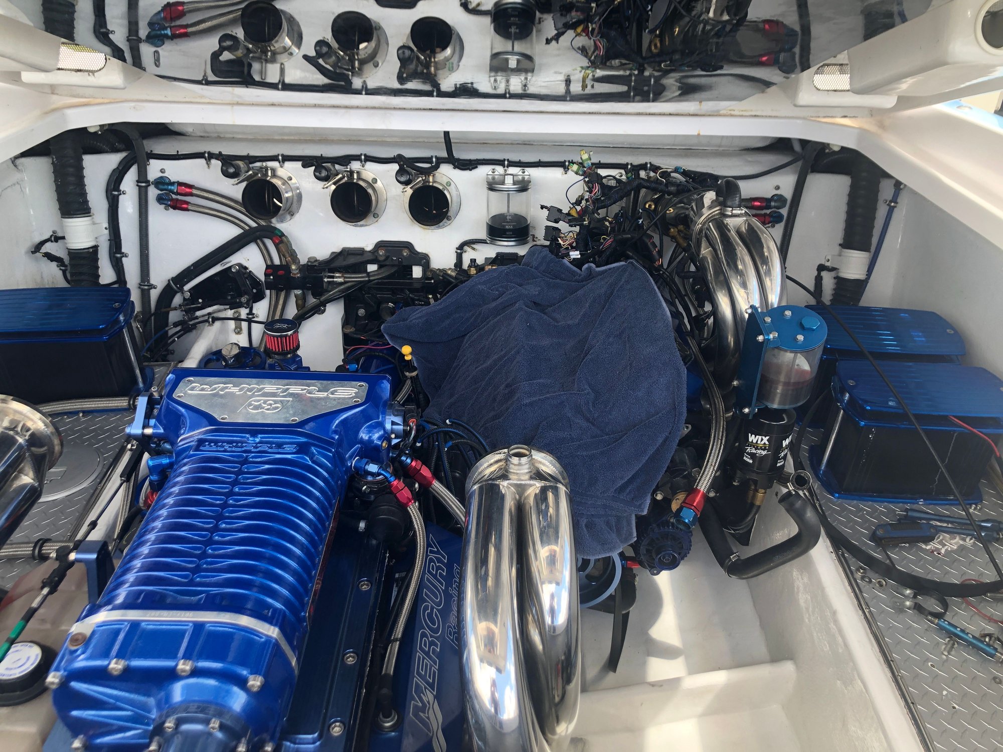

Talked to the engine guy today.
He wants the whole engine. (Actually just the long block. says I can save a few bucks by removing all the accessories)
Hope it's just the top end. Otherwise this thing just became a REALLY expensive Hp 500. Coulda bought a rebuilt 525 for what I'm looking at now. (including purchase price of the used engine)

That sucks to hear, but based on what you described, it’s probably just up in the heads. Doesn’t hurt to get a sampling on the rest of its condition while out though.

Looks like you have through hull exhaust, so I wouldn't worry about the cam. To get water ingestion you need back pressure and you'll get very little with through hull exhaust.
I'm surprised the shop said an hour to remove the engine. It comes out quick, but not really that quick two guys can have it out in an hour, but that's two hours shop time.
I agree with most everyone, I want to see the bottom end and make sure it's solid. However, sounds a like top end problem. Did you hear noise from the engine when you launched? The poor leak down could be from bad valve adjustments, bent push rod, leaky valve, or any number of other things. But it does sound like a top end problem. Poorly aligned piston rings during assembly can also result in a bad leak down test, but this is such a rookie move I doubt that's the issue. If the motor was new and wasn't fully broke in, i.e. rings seated, that could also do it.
Based on the thread, pull the motor, have it torn down, inspected, then reassembled. One problem though; I fully balance all my motors - it makes a HUGE difference. So, if it were MY engine, I would have the whole thing re-balanced to be sure.
