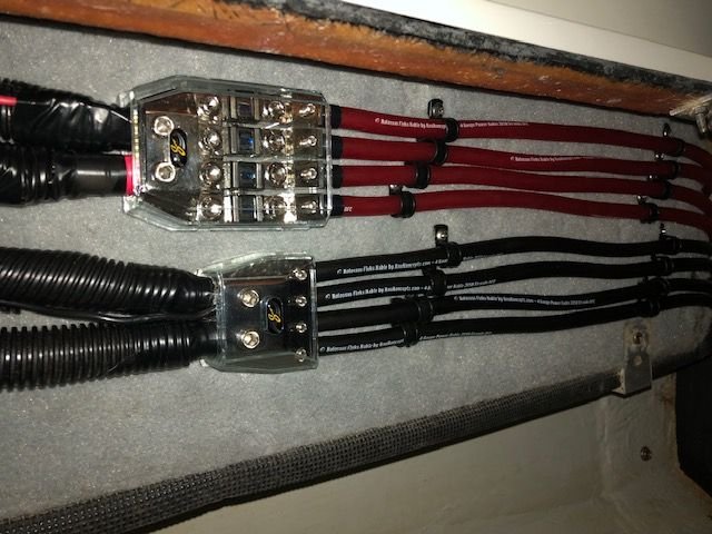

SABER28 09-27-2021 09:57 PM
how many batteries does this boat need?
SB 09-27-2021 10:17 PM
Good catch. Lol.
Must be a party boat. :thumbs

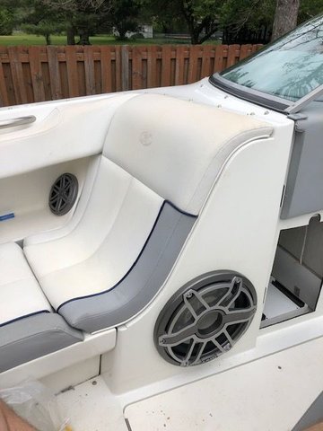

2 for the engine and 2 for the stereo
I can always add 1 for the engine into the stereo bank if need be.
I call it the party barge.
(4) amplifiers
(8) 6.5" speakers
(4) 8.8" speakers
(2) 12" subwoofers .
Blue LED lights in the speakers and throughout.
https://cimg6.ibsrv.net/gimg/www.off...c3e761c652.jpg
