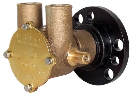

Jabsco Industries makes a decent crank driven pump.
https://th.bing.com/th/id/R.44b368b9...pid=ImgRaw&r=0
https://d1mv2b9v99cq0i.cloudfront.ne...I0YjhhY2EifQ==
TomZ 03-18-2022 12:51 PM
I’m using the 6-series version of this pump.
