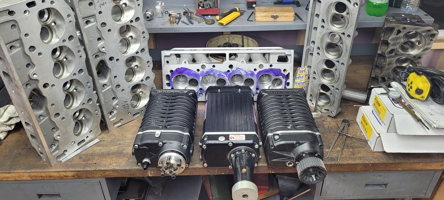

Black Friday 40% sale today for $246 for the win. I also bought 2 BBC 8-71 intakes and 3 LS 102mm throtlle bodies. I guess there is no turning back now...

I'll update my Holley EFI thread once I start building the Whipple stuff.
And I'll start a thread on my 5.0 if anyone is interested. I still don't know how this is going to go together at the moment. I'm just winging it. lol
