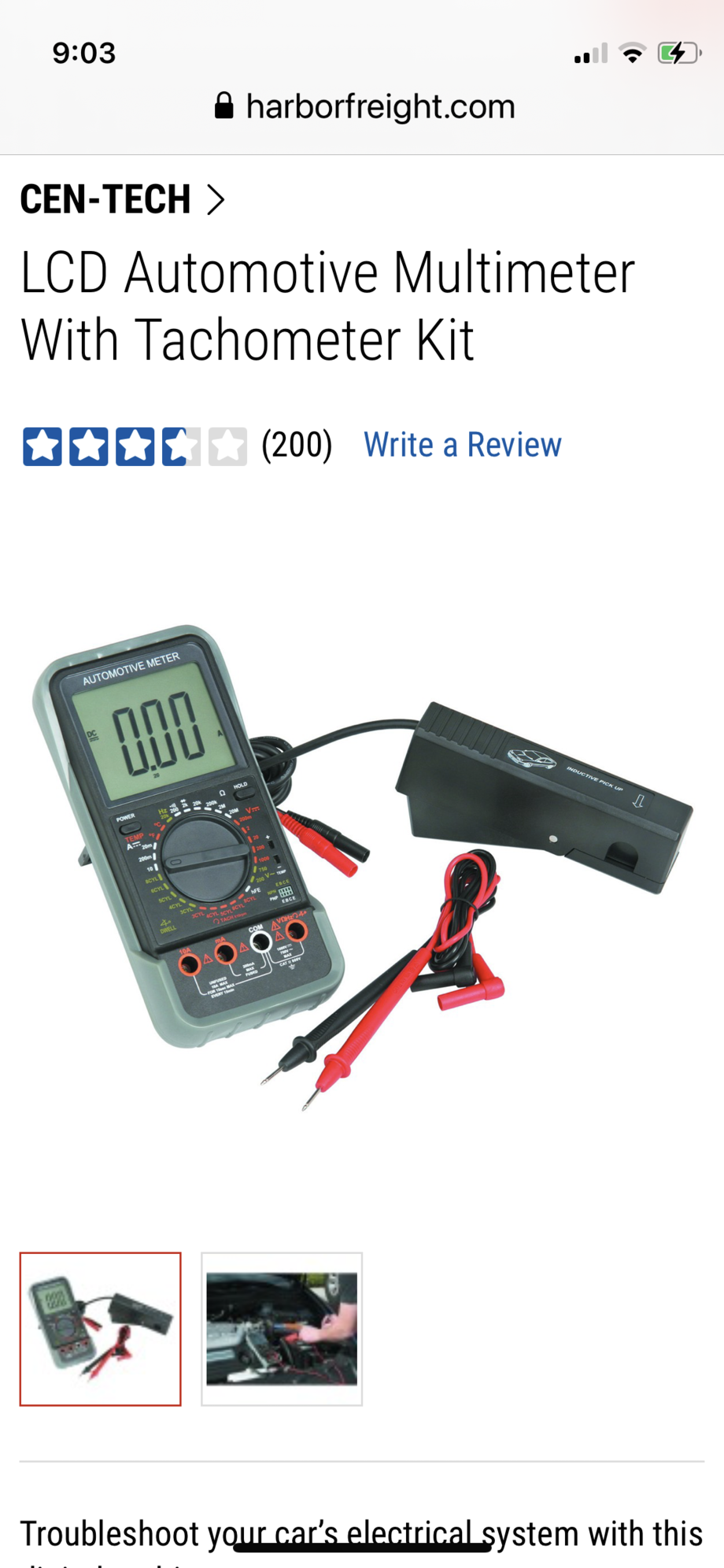

Yes, voltmeter tach.

thats my volt meter on left set to tach, it only reads 3 numbers, 850 rpms would read 085.
3500 rpms would read 350.
