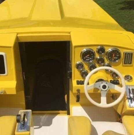

I primarily drive and throttle the boat, but would like to use the passenger side throttle during poker runs or long, spirited runs while having someone else drive. Right now there are 2 separate cables (1 to each throttle), but I have to manually disconnect one and hook up the other at the carb to swap. I would like to be able to alternate back and forth without having to swap the cables. Just curious if there is anyway to setup both throttles to work simultaneously?
- Do they make a carb cable stud to accept 2 cables at same time? If so will it be hard tension on the levers BC of 2 throttles/cables?
- Any other methods to have them run both throttles at same time?
Sorry for the poor pic, but this is my current setup
Thanks in advance!

SO here's what I think we worked out.... Installing a standard carb throttle cable stud and installing the main throttle, then using a small threaded spacer or coupling nut, and then a quick disconnect cable stud/ball joint for the passenger throttle. That way the main throttle always works, and can hook up the passenger side for poker runs, etc... Yet the driver's side will still work without popping the hatch to disconnect.... yet is still quick to connect or disconnect if desired. Just need to also create a double cable clamp bracket, which shouldn't be difficult. If that all makes sense?
Just will have to test and make sure the tension isnt too tight with double the mechanism.
