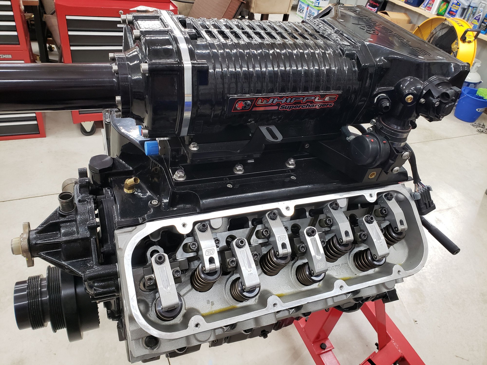

Originally Posted by Keith Atlanta
I have a similar HO600 setup. Its reliable. If they made it to 130 hours they will make it 500 more. The only issue is getting the fuel pressure right, obviously, its right or they wouldnt have made it this long. Ryan00JT is 100% correct, all the weak points were replaced. The Raylar heads are really nice equipment. Its a reliable setup. I would go as far to say its more reliable than a stock HO because they replaced the cast pistons and stock valve springs - the stock valve springs scared the chit out of me...
Your opinion then is it is likely these kits were properly installed else issues would have arisen. Of course perhaps they did and were dealt with

I don't think I'd look at these as "kits" being applied to a 496. These were essentially new engines with exception of the block and crank. I wouldn't give one thought about going back to the factory set-up.

My experience with the Raylar stuff has been good. I believe the quality of the installation is key to reliability. Mine has been reliable so far, and I'm building one now for a friend.
