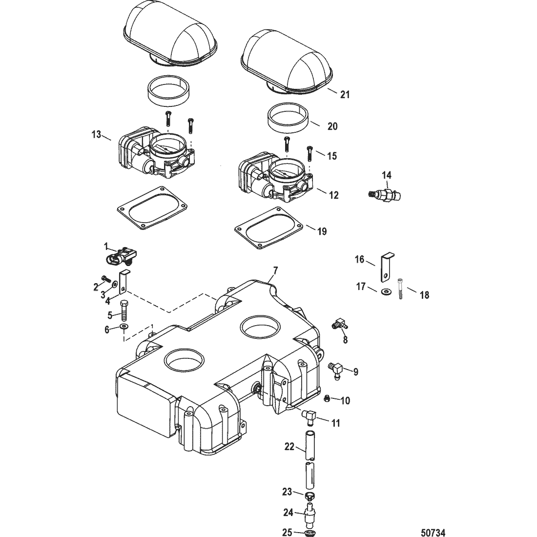

From microfiche, more like 525efi intake with two tbodies on top
https://www.mercruiserparts.com/565-efi-0m967821-up
