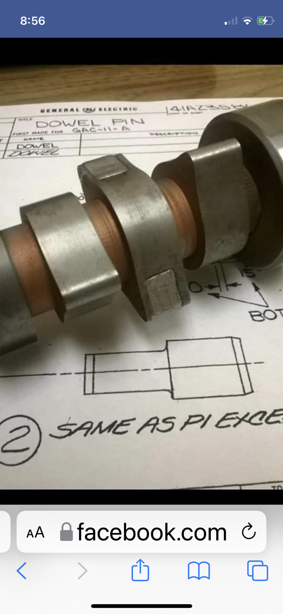

Or this: (yes, these where real…lol)
SB is online now
Looks like something I’ve dreamt about doing when I can’t get chit out of my head. 😂
