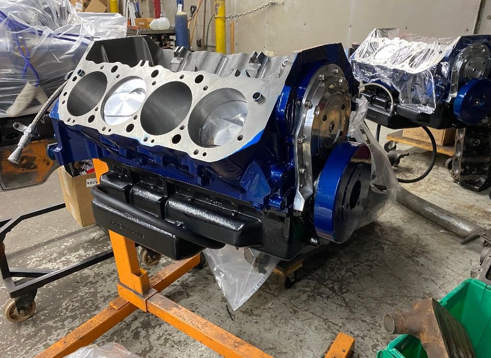

Hi, I am having issue finding the correct pan for my application. Looking at other posts I see a lot of you use Milodon oil pans. On Milodon's website the marine pans are full length sumps that will not fit on my engines. Can I use a street strip for a marine. What type of oil pans are you running. My engine are a BBC Gen 4 Eight qts.
I found Canton 18-360 none in stock and a bit pricey. If have to go that way I guess I would have no choice.

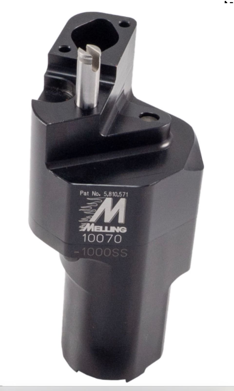

The other day I ordered Hamberger's Ham 1488. After they were shipped I found out they are not rated for marine, They leak oil at the seams and at the screws holding the windage tray on. I also found out you cannot use your Melling M77 HV pump.. it will not fit you have to use their pump and pickup and to top it off it is not an 8 qt pan as advertised. Someone had an issue with a marine engine and had catastrophic bearing failure. I wrote an email to the manufacturer (Hedman).. I received no answer....Great company!
This is the last part I need for my engines to be completed...
Please help

You can't use the HV pump with these pans either for some reason. I installed a regular melling pump with it and is working great.

I looked at that pan but it won't fit due to my Gil high performance engine mounts. steel tube runs from one side to the other side engine mounts which takes up 5 inches. so a full length pan won't work. The front of the pan must be tapered down to about 4" or to the stock pan.
Thanks

I bought the Hardin Marines for my builds. Good quality and more importantly the oil pumps are billet and no chance of the pick ups falling off at the weld. I’ve seen two engines destroyed now in less than a year due to pick up failure. I’m really surprised that Mercury don’t install billets in all their HP engines.
The weld were both just tacked in two places. The weld held fine however the die cast simply broke off behind the weld and they weren’t even a pressed fit. Slid in and out very easily.
