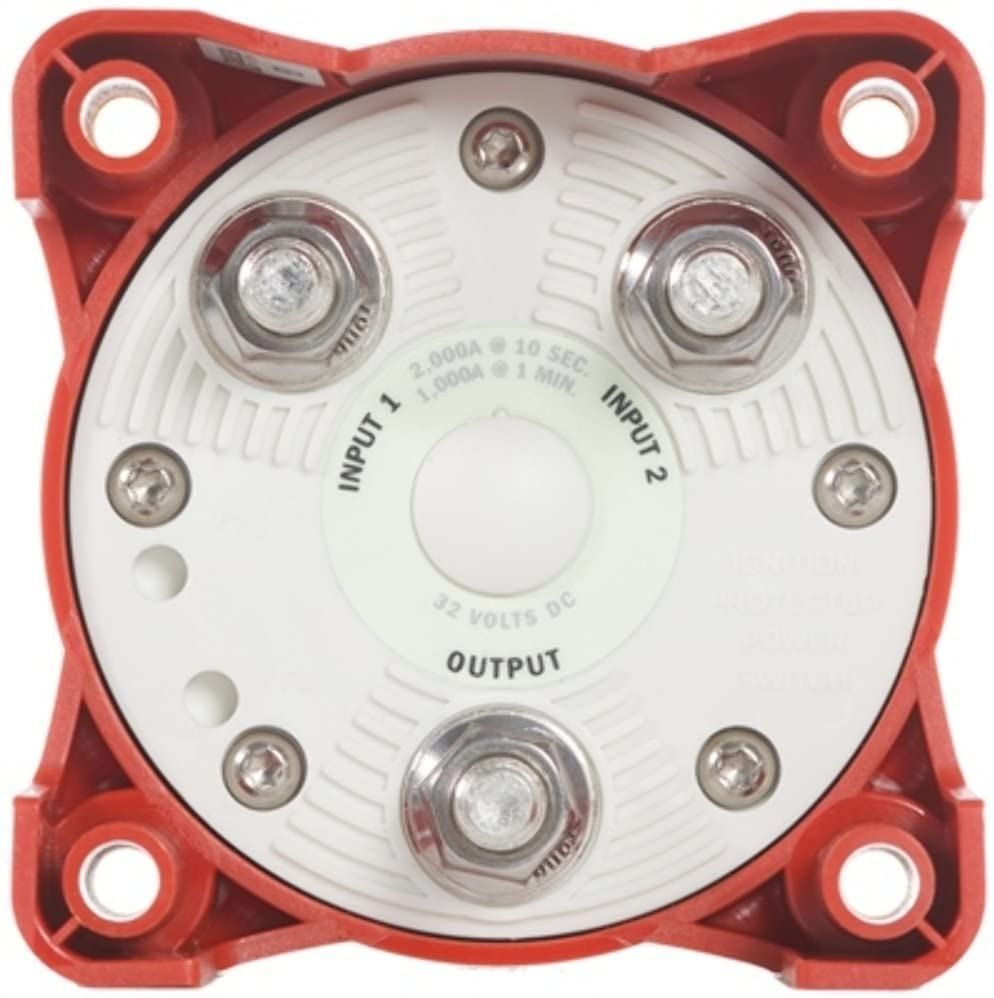

I have two batteries and a Blue Seas manual switch. When the starboard side is on I get good voltage to the dash and engine. When the port side is on I get almost nothing at the dash and will not turn over the engine. A vom at the battery reads 12.4 volts. All connections at the switch are tight and corrosion free. Where do I go from here, please?

so, back of switch at connection posts…..bad side still shows 12.4 volts ? But cable out post (one to starter usually) shows what when bad side switched on ? If low like your gauge this shows bad switch.

SB I get good voltage at both inputs...when switched on nothing at output terminal. Therefore bad switch??? I assume better to replace them disamble and try to fix? Any thoughts on better switch?

Out put term must show something when switch is on the side that makes your guagescwork and starter engage. Right ?

I use Amazon for reviews. Lots of good info buried in there. The Blue Seas switches have fallen apart internally on several peeps. None that i can find find with the perko’s.
Blue Seas:
https://www.amazon.com/Blue-Sea-Systems-Battery-Switch/dp/B00558LSJE https://www.amazon.com/Blue-Sea-Systems-Battery-Switch/dp/B00558LSJE
perko:
https://www.amazon.com/SEACHOICE-11501-Battery-Selector-Switch/dp/B000XBEUIO https://www.amazon.com/SEACHOICE-11501-Battery-Selector-Switch/dp/B000XBEUIO

Battery switches can go bad, but my money is on one of your batteries has an internal failure. Perhaps a dead cell, open circuit, or loose terminal somewhere.
