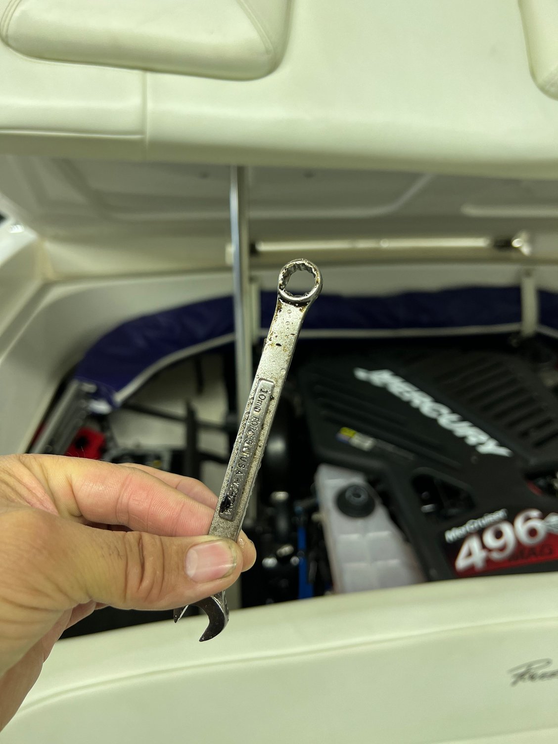

Brad Christy 08-16-2022 07:31 AM
Originally Posted by SB (Post 4841325)
Brad, don’t be silly. 10mm tools are never found. :wink :) Thus the million lost 10mm tools memes.
https://cimg4.ibsrv.net/gimg/www.off...648ea0125.jpeg
SB,
https://cimg8.ibsrv.net/gimg/www.off...97069fb2f.jpeg
https://cimg9.ibsrv.net/gimg/www.off...10848095f.jpeg
Au contraire, mon frére…..
Thanks. Brad.
