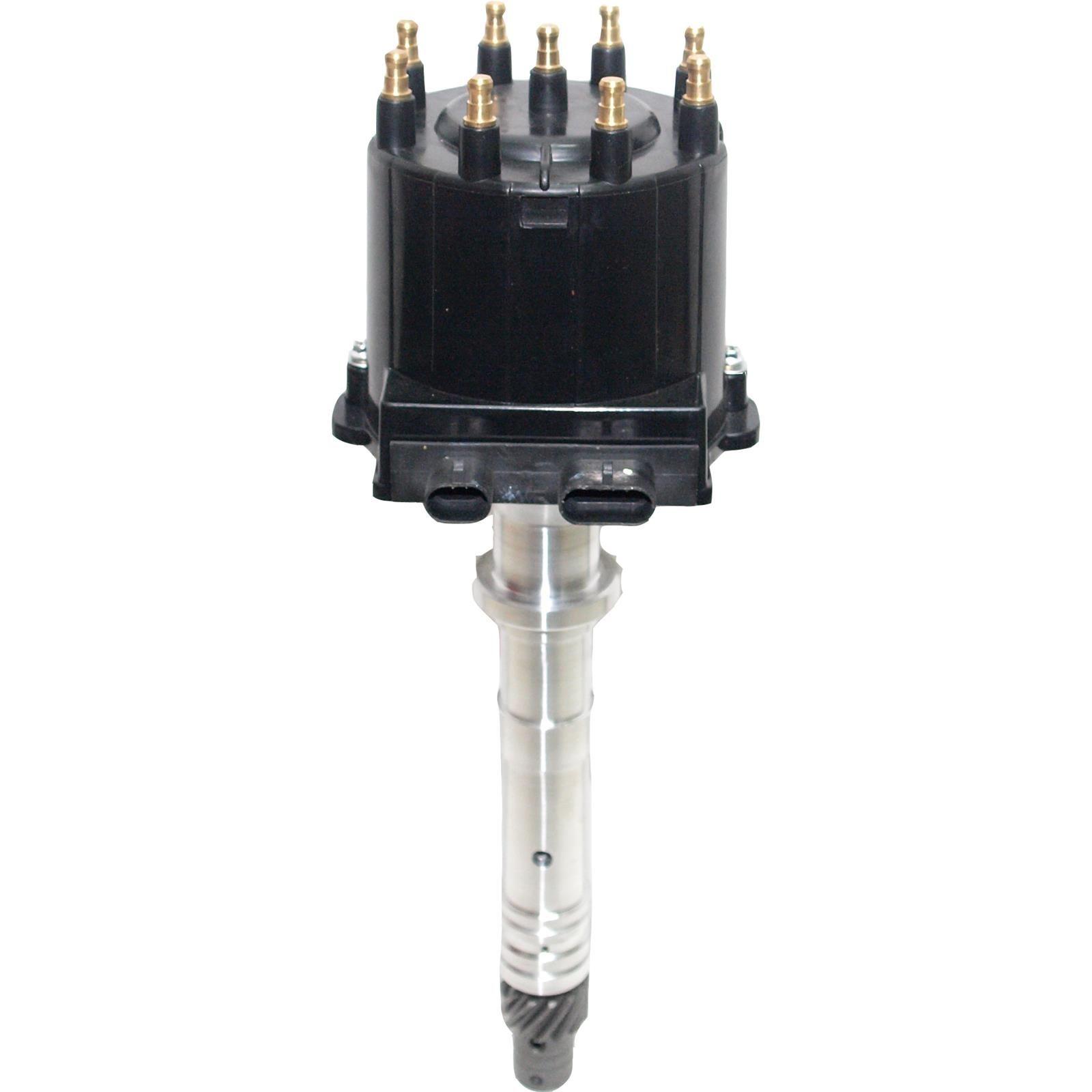

The distributor, I don't know what is what, so how can i identify? it is the distributor with the pick up coil and the ignition control module inside it. 2 connectors, the 4-pin is all for the ECU, Ref LOW, REF HI, BYPASS and IC. the 2-pin is + and "C" to the ignition coil.
Merc Est / gm voyager / gm late model external coil hei / etc, etc. Has lots of names
https://cimg8.ibsrv.net/gimg/www.off...7ce8569cc.jpeg
AP700 07-22-2022 07:56 AM
yes should be this one. replaced the pick up coil ant the module serveral times. always used heat paste under the module.
